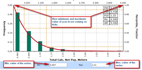

Hello Steema Support,
I am using tee chart line series in Silverlight application, here I am facing one problem related tee chart Axes management in my chart Top axes are getting displayed but in top axes my minimum and maximum value of axes is not coming on ticks.
tChartGraph.Axes.Top.Maximum = lst_X_Axis__ForLine.Max();
tChartGraph.Axes.Top.Minimum = lst_X_Axis__ForLine.Min();
tChartGraph.Axes.Top.Increment = (tChartGraph.Axes.Top.Maximum - tChartGraph.Axes.Top.Minimum) / 8;
It will so helpful for us if you please provide any solution.

Hello Amo,
I have made a simple code where your problem doesn't appear for me.
            Steema.TeeChart.Silverlight.Styles.Line line1 = new Steema.TeeChart.Silverlight.Styles.Line(tChart1.Chart);
            Random rnd = new Random();
            for (int i = 0; i < 100; i++)
                line1.Add(i * 0.001, rnd.Next(100));
            line1.HorizAxis = Steema.TeeChart.Silverlight.Styles.HorizontalAxis.Both;
            tChart1.Axes.Top.Labels.ValueFormat = "#,##0.###";
            tChart1.Axes.Bottom.Labels.ValueFormat = "#,##0.###";
Could you tell us if in previous code works in your end?
