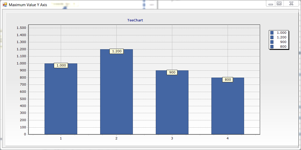

We have an issue when trying to set the maximum value for the left axis.
This is my code snippet:
chartToTest.Aspect.View3D = false;
chartToTest.Axes.Left.AutomaticMaximum = false;
chartToTest.Axes.Left.Maximum = 1400;
Steema.TeeChart.Styles.Bar bar = new Steema.TeeChart.Styles.Bar(chartToTest.Chart);
bar.MarksOnBar = true;
bar.Add(1, 1000);
bar.Add(2, 1200);
bar.Add(3, 900);
bar.Add(4, 800);
So, as you can see, I set the maximum value for the left axis to 1400.
But, if you take a look to the chart in the attached screenshot, you can see that the maximum is 1550.
What can I do to have the maximum set to 1400.
Thanks in advance,
Marijke Van Bergen

Hello Marijke Van Bergen,
My recommendation is change the value of MaximumOffset if you want the axis left values are changed correctly. See next line of code:
 tChart1.Axes.Left.MaximumOffset = 1;

Hello Sandra,
Thanks for your suggestion, but unfortunately this does not help.
I added the MaximumOffset to my code, but chart still looks the same.
Kind regards,
Marijke

Hello Marijke,
Could you tell us which version of TeeChartFor.Net are you using, because next code works fine for me in latest version of TeeChartFor.Net 2012?
            Steema.TeeChart.Styles.Bar bar = new Steema.TeeChart.Styles.Bar(tChart1.Chart);
            bar.Add(1, 1000);
            bar.Add(2, 1200);
            bar.Add(3, 900);
            bar.Add(4, 800);
            tChart1.Axes.Left.AutomaticMaximum = false;
            tChart1.Axes.Left.Maximum = 1400;

Hi Sandra,
Sorry... my mistake. I tested once more and now I see that it works. Thanks for your help.
Marijke
