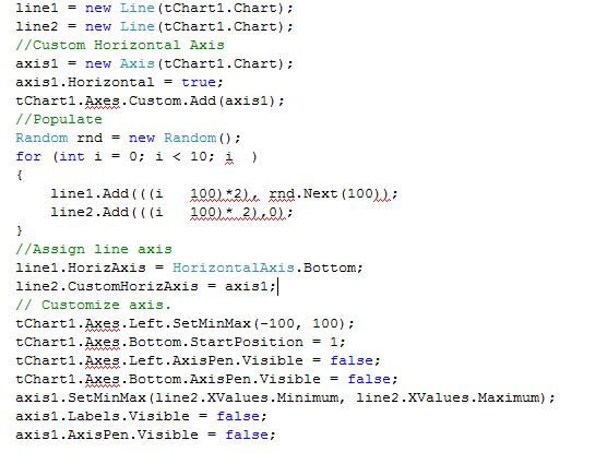

Ok. I have made a simple project where the first line is drawn gap to left axis and second line is drawn on the left axis. To achieve it I have used a extra horizontal axis I have assigned to second line. Please, see next code:
      Steema.TeeChart.Styles.Line line1, line2;
        Steema.TeeChart.Axis axis1;
            line1 = new Line(tChart1.Chart);
            line2 = new Line(tChart1.Chart);
            //Custom Horizontal Axis
            axis1 = new Axis(tChart1.Chart);
            axis1.Horizontal = true;
            tChart1.Axes.Custom.Add(axis1);
            //Populate
            Random rnd = new Random();
            for (int i = 0; i < 10; i  )
                line1.Add(((i   100)*2), rnd.Next(100));
                line2.Add(((i   100)* 2),0);
            //Assign line axis
            line1.HorizAxis = HorizontalAxis.Bottom;
            line2.CustomHorizAxis = axis1;
            // Customize axis.
            tChart1.Axes.Left.SetMinMax(-100, 100);
            tChart1.Axes.Bottom.StartPosition = 1;
            tChart1.Axes.Left.AxisPen.Visible = false;
            tChart1.Axes.Bottom.AxisPen.Visible = false;
            axis1.SetMinMax(line2.XValues.Minimum, line2.XValues.Maximum);
            axis1.Labels.Visible = false;
            axis1.AxisPen.Visible = false;
Could you tell us if previous code works in your end? If you have any problems please let me know.

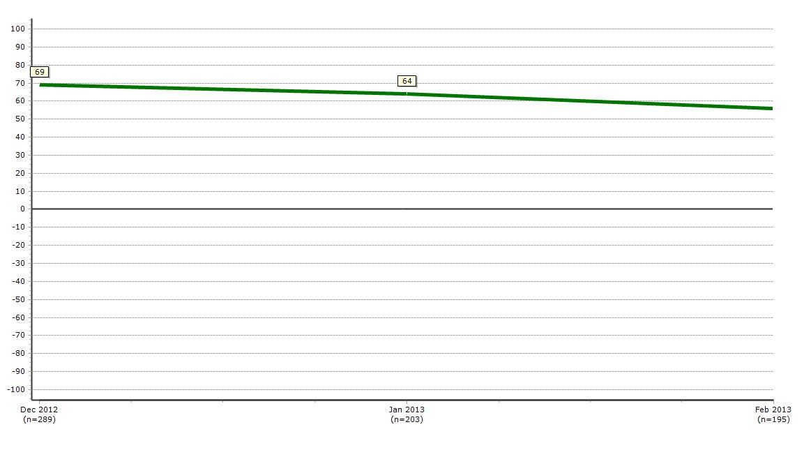

Ok that work fine, will have to try work out the issue with my app, as mine is a web app
Can the -100, 0 , 100 on the Y Axis scale be made bold?
Can the X Axis be inline with -100 and not below, I have the following code for the scale
WebChart1.Chart.Axes.Left.SetMinMax(-100, 100);

Great, works see new sample,

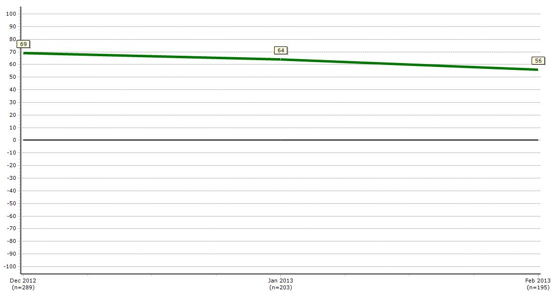

Can the X Axis be inline with -100 and not below?
Re: Line next to Y Axis
Post by Sandra » Wed Mar 20, 2013 3:02 pm
Hello mikethelad,
I am afraid I can not reproduce your problem using last version of TeeChartFor.Net, could you tell us which version are you using? On the other hand, a solution for you is change the minimum offset of Left Axis, as do in next line of code:
WebChart1.Chart.Axes.Left.MinimumOffset = -1;

Post by mikethelad » Wed Mar 20, 2013 3:26 pm
Thanks, had this set for some reason
WebChart1.Chart.Axes.Left.MinimumOffset = 15;
Assume Bold of the 0 ,100 and - 100 on the scale is not possible
