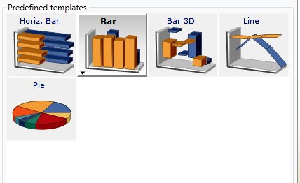

My question was how to programatically select on of the chart types on the gallery panel itself (without any sample chart shown).
I want to show a gallery panel but with 'Bar' styles chart already selected, then in your code it would be something like this:

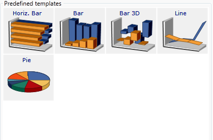

galleryPanel1.SelectedChart = galleryPanel.Charts(1) <---- this assignment does not work. Well, the property is set correctly, but I can't see it on the screen. Bar series chart is not selected (highlighted).
I attached two sample screenshots.
selected.png - this is how I would like gallery panel to look like
notselected.png - this is how it looks now though I set galleryPanel1.SelectedChart property to a correct value.

Sorry for the delay. The property you are using to set the Chart(galleryPanel1.Charts(1)) is correct, but you must change the style of subChart as I make in next c# code:
Could you tell us if previous code works as you want?

Thanks Sandra, now it works.
But, IMHO, SelectedChart property setter should do this code "for us", so we don't have to know all these visual panels, gradients, levels changes. But it's just my suggestion.
