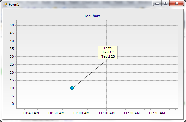

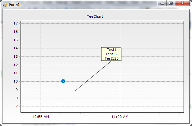

The DragMarks tool in TeeChart behaves wrongly when the chart is zoomed or panned. The connector line looks misplaced after zooming or panning the chart. This doesn't happen is the marks are not dragged.
Here is the screenshots of the same,
Before Zoom:
Before Zoom
After Zoom:
After Zoom
Please let me know how this issue can be fixed.

My issue is not with the DrawLine tool. I have issue with the DragMarks tool. I don't find the code you have given useful to me in anyway.
What I'm looking for is, after dragging a series mark, if I zoom, the mark should move along with the point. But that is not happening. I believe this is a bug and needs to be fixed. i.e., currently dragging the series marks sets position of the mark to absolute value, instead it should actually be a relative value. And when the chart is zoomed or panned, the marks should be repositioned according to the current pointer position.

Sorry. I didn't understand your problem correctly, I have added your request in bug list report with number [TF02016470]. We will try to fix it to upcoming versions of TeeChartFor.Net.
