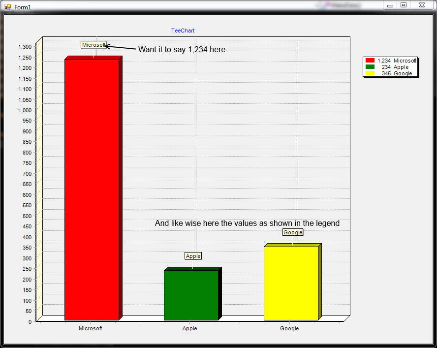

Okay is a simply example VS2010 app that uses TeeChart v2 and targets .NET 2.0.
I've also attached a screenshot of the this test app with indicators of what I am trying to achieve.

Re: On Bar series how to show Y value as Mark and Label
Post by Sandra » Fri Nov 30, 2012 12:10 pm
Hello occ,
Ok. I have modified your code, where I have used GetSeriesMark event to change the text of Marks

Thanks for that :D . A bit of crossed wires between my first post description and the example as I want all the bars to have the value shown as the label.
So in fact the required code is as simple as adding:
barSeries.Marks.Style = MarksStyles.Value;
Anyhow your posted code was great as I might need to add some formatting and hence add a handler to set the text as you had in your example.
