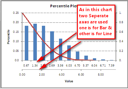

I am using Tee chart in SilverLight Application in this chart I am using two Series one is Bar and another one is line. For Line series I am using Bottom axes as X value and Right Axes as Y value and Bar series Left axes is Y value . I want to Show two separate Bottom Axes one is For Bar Chart and another one is for Line as it is shown in attaching Image.
Any suggestion will be highly appreciated.

In that case you can use custom axes. You'll find information in tutorial 4 and the All Features\Welcome !\Axes\Permanent custom axes example in the features demo. Both tutorials and demo are available at TeeChart's program group.

Thanks for the reply, but I want to show axes in the manner which I have shown in previously attached image and by that tutorial of the tee chart it is possible only on that similar bottom axes but I want to use two separate bottom axes one is for Line & other one is for bar and all the time both axes must be visible.
