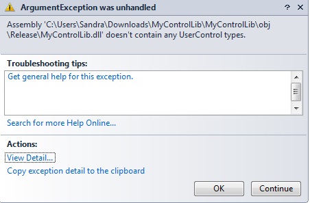

Hello Nik,
We haven't achieved execute your project, so, appears next Argument exception:
Can you tell us what do we do to solve the problem? Or if you prefer, you can send us a correct project that we can run as-is here.
