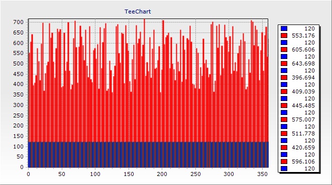

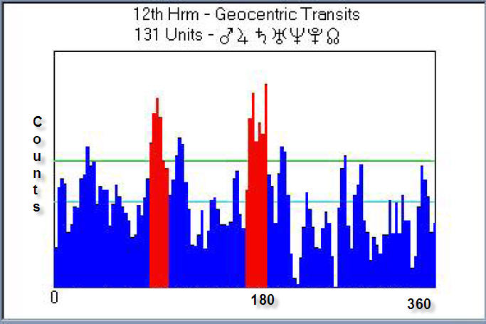

I'm trying to add values to a histogram where the vertical axis is the count and the horizontal axis are slices from 1 to 360 (which represents degrees of planetary positions in a circle)
But when I try and add values to the histogram line type I can't seem to accomplish this:
As an experiment I did this:
For intCnt = 1 To 1000
If intCnt Mod 2 = 0 Then
Me.tChartGeo360.Series(0).Add(120)
Else
Me.tChartGeo360.Series(0).Add( CInt(Int((360 * Rnd()) + 1)))
End If
Next
This should have 500 counts for the 120 degree slice and the rest of the slices random but it doesn't.
In the examples and documentation you use the FillSampleValues method so not sure what to pass in.
I know this is probably a dumb question but how do i do this?
Thanks so much!
Joseph

Re: Histogram Newbie
Hello Joseph,
Using your indications I have used two different ways to get an histogram.
The first options is using a Histogram Series as do in next code:
With previous code I could get next result:

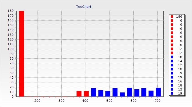

The second, way is use Histogram functions instead of Histogram Series, as do in next sample code:
With previous code I could get next results:
