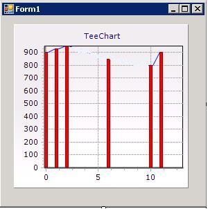

I am using Barjoin.
I have a need to not show the Barjoin line when data for that bar/point is null. Corresponding bar comes as blank but the barjoin line joins to the last drawn point. Here are the actual snapshot and the way I want. Please let me know if this is posssible.
My need.
Actual

I am afraid isn't possible do it directly. I have made a simple code, where I have used SetNull points and three series to achieve as you want:
        Steema.TeeChart.Styles.BarJoin Series1, Series3;
        Steema.TeeChart.Styles.Bar Series2;
            //TChart
            //Series
            Series1 = new Steema.TeeChart.Styles.BarJoin(tChart1.Chart);
            Series2 = new Steema.TeeChart.Styles.Bar(tChart1.Chart);
            Series3 = new Steema.TeeChart.Styles.BarJoin(tChart1.Chart);
            //Add values to Series;
            Random rnd = new Random();
            Series1.FillSampleValues(6);
            Series1.Color = Color.Red;
            Series2.DataSource = Series1;
            Series2.Color = Series1.Color;
            Series3.DataSource = Series1;
            Series3.Color = Series1.Color;
            Series1.Marks.Visible = false;
            Series2.Marks.Visible = false;
            Series3.Marks.Visible = false;
            tChart1.Legend.LegendStyle = LegendStyles.Values;
            tChart1.Draw();
            for (int i = 0; i < 6; i++)
                if (i < 2)
                    Series2.SetNull(i);
                    Series3.SetNull(i);
                else if (i == 2)
                    Series1.SetNull(i);
                    Series3.SetNull(i);
                else if (i > 2)
                    Series1.SetNull(i);
                    Series2.SetNull(i);
                tChart1.Legend.Symbol.OnSymbolDraw += new SymbolDrawEventHandler(Symbol_OnSymbolDraw);
        void Symbol_OnSymbolDraw(object sender, SymbolDrawEventArgs e)
            //Paint null symbols of legend.
            tChart1.Graphics3D.Brush.Color = Color.Red;
            tChart1.Graphics3D.Rectangle(e.Rect);
            tChart1.ShowEditor();
Can you tell us if previous code works in your end?
