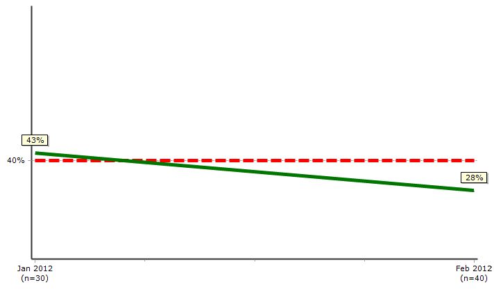

mikethelad
Posts: 58
Joined: Thu Jul 05, 2012 12:00 am
Re: percentage mark on the Y- axis
Post by mikethelad » Fri Sep 14, 2012 10:24 am
I only getting one % value if I do this, see example

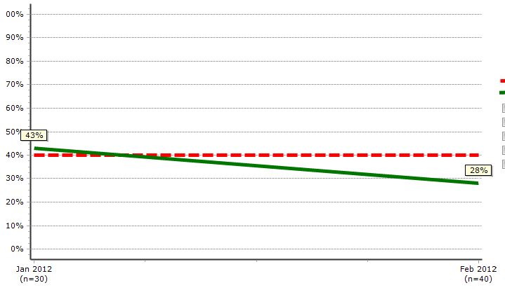

Post by mikethelad » Fri Sep 14, 2012 3:34 pm
Nearly, the 100% is being choppied to 00%, I have tried increasing the offset to 15
WebChart1.Chart.Axes.Left.MinimumOffset = 15;
WebChart1.Chart.Axes.Left.MaximumOffset = 15;
Post by Sandra » Mon Sep 17, 2012 9:34 am
Hello mikethelad,
I can try to reproduce your problem but it not occurs for me using last version of TeeChartFor.Net and next code:
    Steema.TeeChart.Chart tChart1;
    protected void Page_Load(object sender, EventArgs e)
        tChart1 = WebChart3.Chart;
            tChart1.Legend.Alignment = LegendAlignments.Bottom;
            for (int i = 0; i < 2; i++)
                new Steema.TeeChart.Styles.Line(tChart1.Chart);
                tChart1[i].Marks.Visible = true;
                AddValues(tChart1[i], 2);
                tChart1[i].Marks.Style = Steema.TeeChart.Styles.MarksStyles.Percent;
            tChart1.Axes.Left.GetAxisDrawLabel += new GetAxisDrawLabelEventHandler(Left_GetAxisDrawLabel);
            tChart1.Axes.Bottom.MaximumOffset = 2;
            tChart1.Axes.Bottom.MinimumOffset = 1;
            tChart1.Axes.Left.MaximumOffset = 15;
            tChart1.Axes.Left.MinimumOffset = 15;
            tChart1.Axes.Left.SetMinMax(0, 100);
        private void AddValues(Steema.TeeChart.Styles.Series s, int value)
            Random rnd = new Random();
            for (int i = 0; i < value; i++)
                s.Add(i, rnd.Next(100));
        void Left_GetAxisDrawLabel(object sender, GetAxisDrawLabelEventArgs e)
            e.Text = e.Text + "%";
Please see previous code and check if your problem occurs using it. If occurs, please can you tell us which version of TeeChart are you using?
On the other hand, seeing your image seems the 100% doesn't appear, because the margin is slimmer than default margin of WebChart. If is the case, I recommend you change the size of your margin left as I do in next line of code, because the labels can draw correctly:
  tChart1.Panel.MarginLeft = 10;
