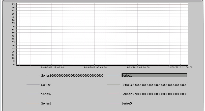

In the teeChart contol the charts shrinks inside the control to adjust the legend,
Attached for reference,do we have any property to set the height and width percentage of the chart inside the control?

I can not reproduce your problem using next code:
            tChart1.Legend.Alignment = LegendAlignments.Bottom;
            for (int i = 0; i < 8; i++)
                new Steema.TeeChart.Styles.Line(tChart1.Chart);
                tChart1[i].FillSampleValues();
            for (int j = 0; j < tChart1.Series.Count; j++)
                if (j % 3 == 0)
                    tChart1[j].Title = "Series" + j.ToString()+"0000000000000000000000000000000000";
                    tChart1[j].Title = "Series" + j.ToString();
Can you please check if code works as you want? Moreover can you tell us which version are you using of TeeChartFor.Net?

we are using Tee Chart Silvelight version 4.0.2009.42283 and Dock property is not available in this version.
Please suggest some other alternative.
This is how , we have added the chart control in xaml.
<stc:TChart x:Name="trendControl" HorizontalAlignment="Stretch" VerticalAlignment="Stretch"></stc:TChart>

I inform you that using last version of Silverlight and next code:
 public MainPage()
                new Steema.TeeChart.Silverlight.Styles.Line(tChart1.Chart);
                if (j % 3 == 0)
your problem doesn't appear for me. I suggest your, download last maintenance release of TeeChartFor.Net that you can download here. When you get new version, please try again if our problem persist. If it persists, but using my code you don't reproduce it, please try to arrange a simple project, because we can reproduce your problem here.
