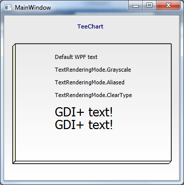

Thanks for your feedback. I don't see this makes any difference though. I tried using this code:
    public MainWindow()
      tChart1.AfterDraw += new Steema.TeeChart.WPF.PaintChartEventHandler(tChart1_AfterDraw);
    void tChart1_AfterDraw(object sender, Steema.TeeChart.WPF.Drawing.Graphics3D g)
      g.Font.Size = 8;
      g.Font.Name = "Tahoma";
      g.TextOut(100, 75, "Default WPF text");
      TextOptions.SetTextRenderingMode(tChart1, TextRenderingMode.Grayscale);
      g.TextOut(100, 100, "TextRenderingMode.Grayscale");
      TextOptions.SetTextRenderingMode(tChart1, TextRenderingMode.Aliased);
      g.TextOut(100, 125, "TextRenderingMode.Aliased");
      TextOptions.SetTextRenderingMode(tChart1, TextRenderingMode.ClearType);
      g.TextOut(100, 150, "TextRenderingMode.ClearType");
      FormattedText text = new FormattedText("GDI+ text!", System.Globalization.CultureInfo.CurrentCulture, System.Windows.FlowDirection.LeftToRight, g.Font.DrawingFont, g.Font.Size * 3, g.Brush.DrawingBrush);
      g.GDIplusCanvas.DrawText(text , new Point(100, 175));
      FormattedText text2 = new FormattedText("GDI+ text!", System.Globalization.CultureInfo.CurrentCulture, System.Windows.FlowDirection.LeftToRight, g.Font.DrawingFont, g.Font.Size * 3, g.Brush.DrawingBrush, new NumberSubstitution(), TextFormattingMode.Display);
      g.GDIplusCanvas.DrawText(text2, new Point(100, 200));
Which produce this chart:
I'm not able to see any difference between the two bottom text lines. Do you see any difference on it? Are you doing any modifications on the code?

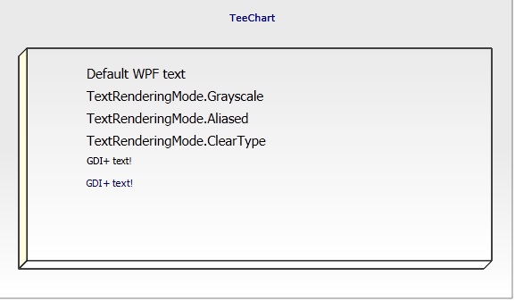

Re: WPF blurry text
Post by Sandra » Tue Nov 13, 2012 2:24 pm
Hello MVUser6,
Sorry for the delay. I have tested your code and I have gotten next image:
Do you get the same result as us? If you have the same results as us, please explain exactly wherewhere is the problem? On the other hand, if the result is different please attached an image with your result, because we can investigate what could be the problem.
