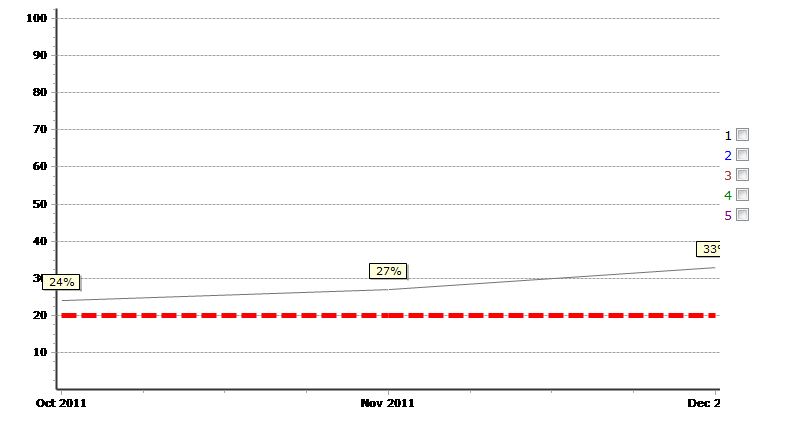

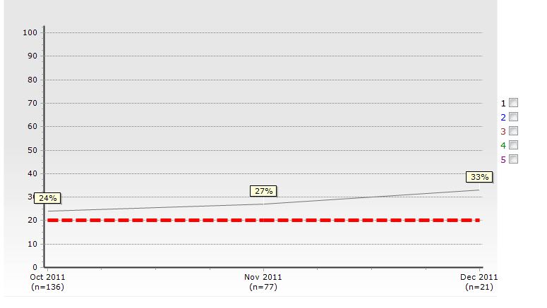

I have set the panel colour to be white as below:-
WebChart1.Chart.Panel.Color = System.Drawing.Color.White;
WebChart1.Chart.Panel.Visible = true;
However this is giving a gradient colour, see sample 1
If I make the panel invisible = false, the fonts then look wrong, how can get remove the gradiant?
with Panel Visible = false
Graph Panel Colour 2.JPG (38.29 KiB) Viewed 3114 times
With Panel Visible
Graph Panel Colour.JPG (39.83 KiB) Viewed 3112 times
Re: Panel Colour
Post by Sandra » Fri Aug 03, 2012 3:28 pm
Hello mikethelad,
I recommend do something as next code:
tChart1 = WebChart3.Chart;
        tChart1.Panel.Gradient.Visible = false;
        tChart1.Panel.Color = Color.White;
        tChart1.Walls.Back.Gradient.Visible = false;
        tChart1.Walls.Back.Color = Color.White;
