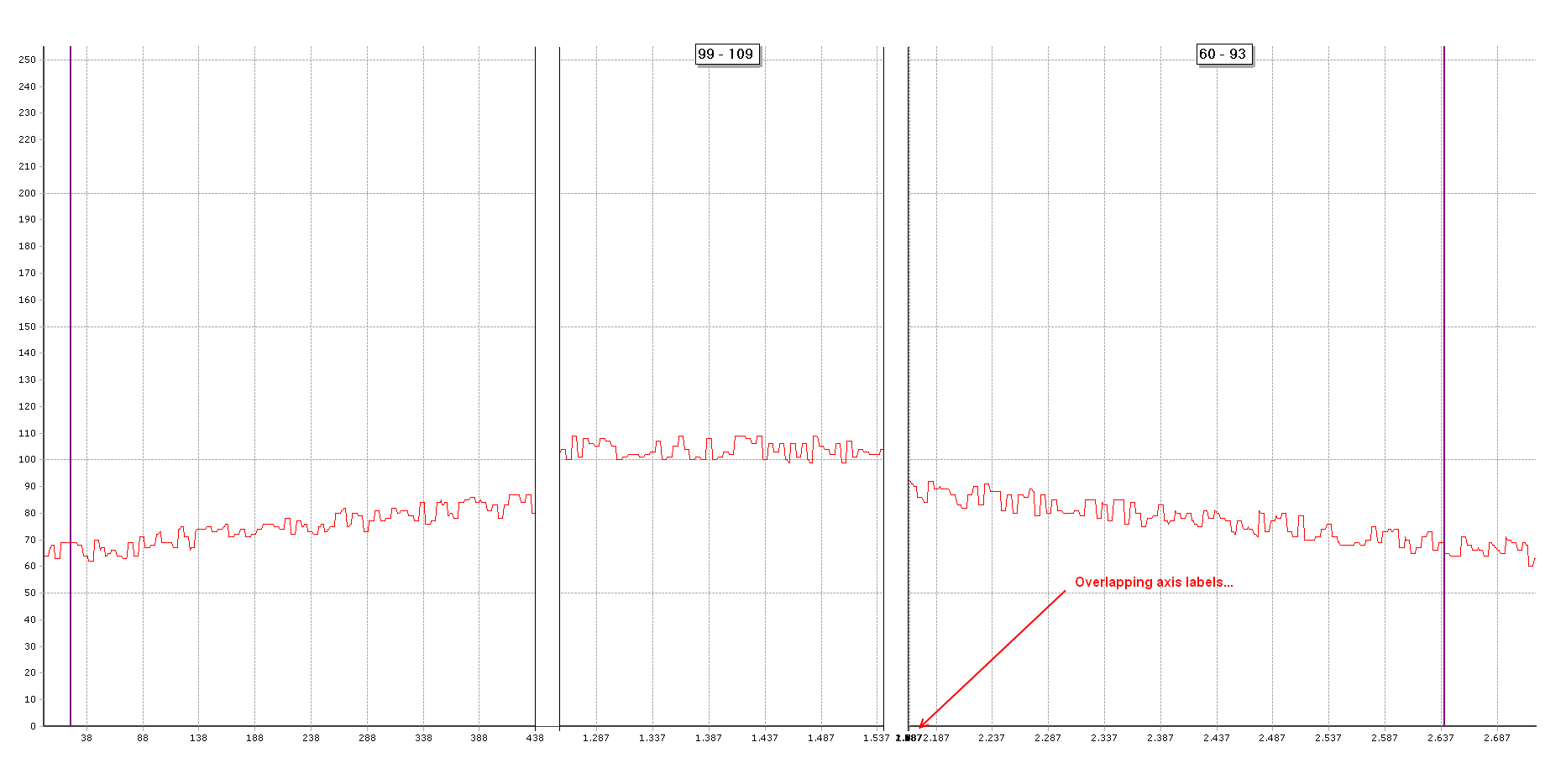

I am using the AxisBreak tool to mask out certain areas of my chart on the x-axis using multiple axis breaks, each with GapSize = 30. In most cases the axis breaks mess up my x-axis labels and it seems that multiple labels get overdrawn then (see image attachment)... Is there any way to avoid this?
overlapping labels.png (91.62 KiB) Viewed 4862 times

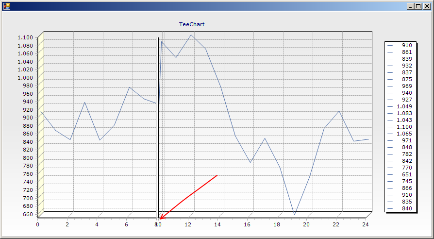

Re: Axis Breaks and corrupt axis labels
Post by Sandra » Thu Jul 19, 2012 2:17 pm
Hello Pilipp P.
The problem of overlaping of AxisBreaks can be solved of many ways,e.g:
1.- Changing the size of GapSize, adapting it to your labels space.
2.- Changing the scale of Axes.
3.- Changing the angle of labels.
4.- Using custom labels, etc.
Basically, you need treat this problem as you treat anyone of problems to overlap as do in this thread.
