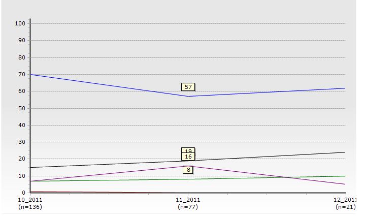

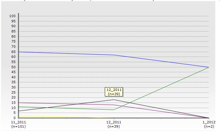

On the sample graph I have set the scale to 0 to 100, by
WebChart1.Chart.Axes.Left.SetMinMax(0,100);
I want it be in qty's of 10 and not 5, ie 10,20,30 etc
Also
I wish to show the marks as values an not as per the bottom axis label, data is being added like:-
footer = mnth + "_" + year + "\n(n=" + totaln + ")";
line1.Add(7, footer);

Hi mikethelad,
You should set Increment property then:
      tChart1.Axes.Bottom.Increment = 10;
You can set Label.Style like this:
      tChart1.Axes.Bottom.Labels.Style = Steema.TeeChart.AxisLabelStyle.Value;
For further information about axis settings please read tutorial 4. Tutorials can be found at TeeChart's program group.

Thanks, that works, see new graph, is there anyway to overcome the following:-
1. Overlap of the marks?
2. How to show the % symbol after the mark value
3. 1st and last one not showing
Re: Scale And Marks
Post by Narcís » Mon Jul 16, 2012 2:16 pm
Hi mikethelad,
Yes, you can do something similar as in the example Pep posted here.
Either using one of the percent related MarksStyles values or manually adding it to the mark text with the GetSeriesMark event:
    void Form1_GetSeriesMark(Steema.TeeChart.Styles.Series series, Steema.TeeChart.Styles.GetSeriesMarkEventArgs e)
      e.MarkText += "%";
Using MinimumOffset and MaximumOffset, for example:
      tChart1.Axes.Bottom.MinimumOffset = 5;
      tChart1.Axes.Bottom.MaximumOffset = 5;
