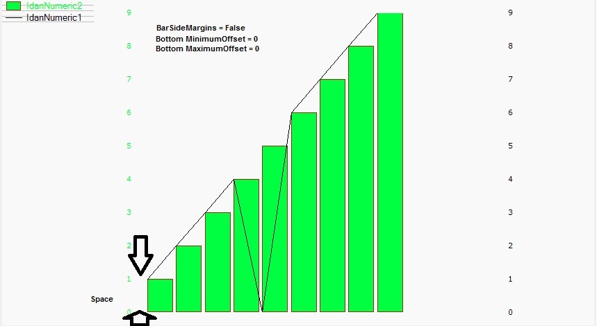

i have some space between the first bar and the start of the chart, even though SideMargins in false.
if i change MinimumOffset or MaximumOffset of Bottom axis from 0 to another value, the first bar "jumps" to the start.
why it doesn't starts from the start of the chart with 0 value?
I can not reproduce your problem, can you please attached an image where you indicate the exactly problem, because we can try to find a good solution for you? On the other hand, can you tell us which version of TeeChartFor.Net are you using now?

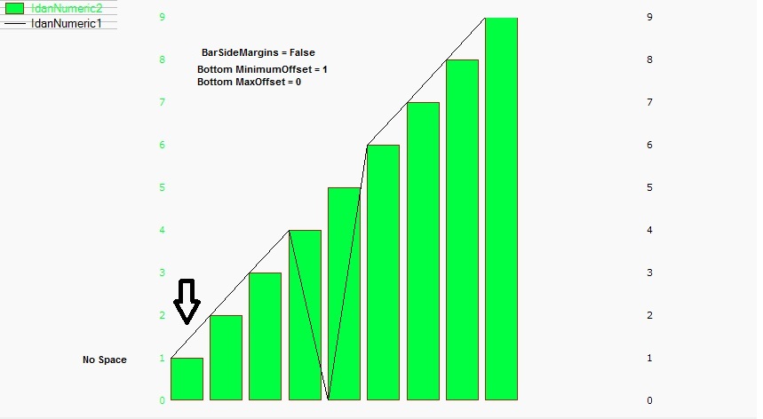

Post by MVuser2 » Sun Jun 17, 2012 8:12 am
i'm using TeeChart version 4.1.2011.6283.
InflateMargins didn't solve me problem.
i posted two screenshots for you to understand the offset problems.
you can load the same chart configuration and data from the file above in my last message(graph_with_data.rar).
when MinimumOffset and MaximumOffset of an axis is 0, there is a strange space.
i cannot reproduce this behavior in VB because there is no MinimumOffset and MaximumOffset there.
i'm trying to understand if there is another way cope with this difference instead of setting offsets, because i'm getting different behavior in VB and .NET application.
Re: Difference between TeeChart 5 and TeeChart 2011
Post by Sandra » Mon Jun 18, 2012 12:39 pm
Hello MVuser2,
Ok, thanks for the information. Checking your code, I have found where the problem is and I think you can solve it if you change the value of OffsetPercent of the Bar Series as do in next lines of code:
        private void button3_Click(object sender, EventArgs e)
            tChart1.Series.Clear();
            tChart1.Import.Template.Load(@"C:\Users\Sandra\Downloads\graph_with_data\graph_with_data.ten");
            (tChart1[2] as Steema.TeeChart.Styles.Bar).OffsetPercent = 10;
Can you tell us if previous code help you to solve your problem?
