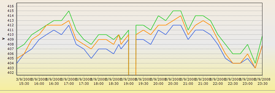

I'm using the chart and using:
series.TreatNulls = Steema.TeeChart.Styles.TreatNullsStyle.DoNotPaint
I have attached an image of how the graph is painted.
My problem is that the lines go to 0 where the null value is instead of just having a missing segment.
Another problem is that when i use down-sampling the null values do not show.

Using last version and next code, your problem doesn't occur for me:
        Steema.TeeChart.Styles.FastLine fast1, fast2, fast3;
            //tChart1
            fast1 = new FastLine(tChart1.Chart);
            fast2 = new FastLine(tChart1.Chart);
            fast3 = new FastLine(tChart1.Chart);
            fast1.XValues.DateTime = true;
            fast2.XValues.DateTime = true;
            fast3.XValues.DateTime = true;
            fast1.FillSampleValues();
            fast2.FillSampleValues();
            fast3.FillSampleValues();
            fast1.LinePen.Width = 2;
            fast2.LinePen.Width = 2;
            fast3.LinePen.Width = 2;
            fast1.SetNull(15);
            fast2.SetNull(15);
            fast3.SetNull(15);
            fast1.TreatNulls = TreatNullsStyle.DoNotPaint;
            fast2.TreatNulls = TreatNullsStyle.DoNotPaint;
            fast3.TreatNulls = TreatNullsStyle.DoNotPaint;
Can you tell us if you can reproduce your problem using previous code? On the other hand, can you tell us which version of TeechartFor.Net are you using?
