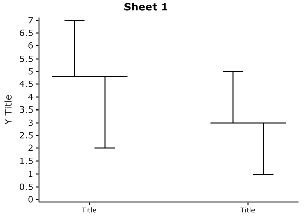

I am trying to add error bars to bar graphs presenting minimum and maximum. I understand that the upper and lower errorbar are always in equal size, and that makes sense charting errors. The distance between mean to minimum, and between mean and maximum are not always equal, in most cases unequal. So I declare two errorbars, upper and lower to chart maximum and minimum respectively. Unfortunetely, the two errorbars are displayed offset from each other. Is there a way to bring both in line?
Cheers
Oli
Here my code:
Dim ErrorbarMin As New Steema.TeeChart.Styles.Error()
Dim ErrorbarMax As New Steema.TeeChart.Styles.Error()
ErrorbarMax.Add(i, GraphData_Mean(i), GraphData_Max(i) - GraphData_Mean(i), labels(i))
ErrorbarMin.Add(i, GraphData_Mean(i), GraphData_Mean(i) - GraphData_Min(i), labels(i))
ErrorbarMax.Color = Color.Black
ErrorbarMax.HorizAxis = HorizontalAxis.Bottom
ErrorbarMax.ErrorPen.Visible = True
ErrorbarMax.ErrorPen.Width = 2
ErrorbarMax.ErrorPen.Color = Color.Black
ErrorbarMax.ErrorPen.Style = Drawing2D.DashStyle.Solid
ErrorbarMax.ErrorWidthUnits = ErrorWidthUnits.Percent
ErrorbarMax.ErrorWidth = 65
ErrorbarMax.ErrorStyle = ErrorStyles.Top
ErrorbarMax.Title = "Error bar, upper"
ErrorbarMin.Color = Color.Black
ErrorbarMin.HorizAxis = HorizontalAxis.Bottom
ErrorbarMin.ErrorPen.Visible = True
ErrorbarMin.ErrorPen.Width = 2
ErrorbarMin.ErrorPen.Color = Color.Black
ErrorbarMin.ErrorPen.Style = Drawing2D.DashStyle.Solid
ErrorbarMin.ErrorWidthUnits = ErrorWidthUnits.Percent
ErrorbarMin.ErrorWidth = 65
ErrorbarMin.ErrorStyle = ErrorStyles.Bottom
ErrorbarMin.Title = "Error bar, lower"
tChart.Series.Add(ErrorbarMax)
tChart.Series.Add(ErrorbarMin)

Hi Sandra,
I have attached a small example project to demonstrate the offset of two errorbars added to one bar. I would like to have the two errorbars aligned.
I am also wondering why the font size of labels in bottom and left axis is different, although I set both to a size of 11. :?:
Please let me know if you require further details on what I am trying to achieve. Thanks for your support :)

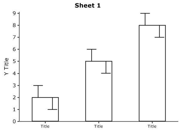

Re: ErrorBar with min and max values
Post by Sandra » Mon Apr 16, 2012 12:29 pm
Hello Oli,
Ok. I have made a simple code using a ErrorBar Series and Error Series where the errorbars are displayed in line

Can you tell us if previous code works as you want?

Hi Sandra,
your code works as long as I am using bar charts. Another type of charts I do in my application is a simple line with errorbars. I create the line with box plot, and set the box and whisker invisible, and the meanline to visible. Then I add two errorss, one for minimum and the other for maximum value. See attachment.
Is the behavior to offsetting the errors expected, or a bug which could be fixed in the near future?
And in your code, the font size of left and bottom axis seems to be different too, even so both are set to a size of 11. Any idea why?
Thanks again
