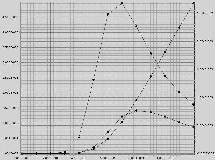

I plot the graph using some points as the first attachment, including x1, y1, y2 axis. But when I remove some points in y1 axis, the graph changed as the second attachment, and first label in x1 axis displayed incomplete. Please help me to resolve it or give me a solution?
The labels is complete
The first label is incomplete

I suggest you try to change your Minimum and Maximum Offset using something as next line of code:
tChart1.Axes.Bottom.MinimumOffset = 20;
Can you tell us if my suggestion help you to solve the problem?
Thank,

Thanks, i resolved it as you said.

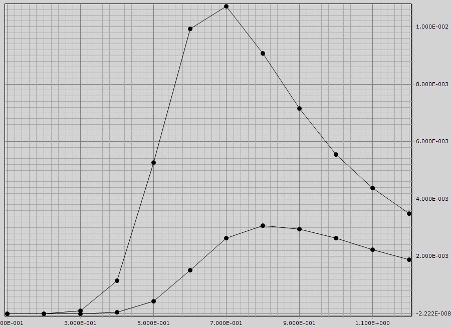

Sorry, the question have not been resolved yet. Perhaps what i said is not clear.
I want that left axis title display, but the points on left axis is disappear. Please help me, thanks.

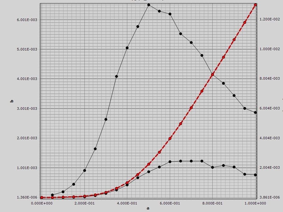

I want the series disappear on left axis, not values. Please see the red line in the first attachment(left_appear).
After remove the series, the graph will changed as the second attachment(left_disappear), but I want the left axis title display.
Please again, thanks.

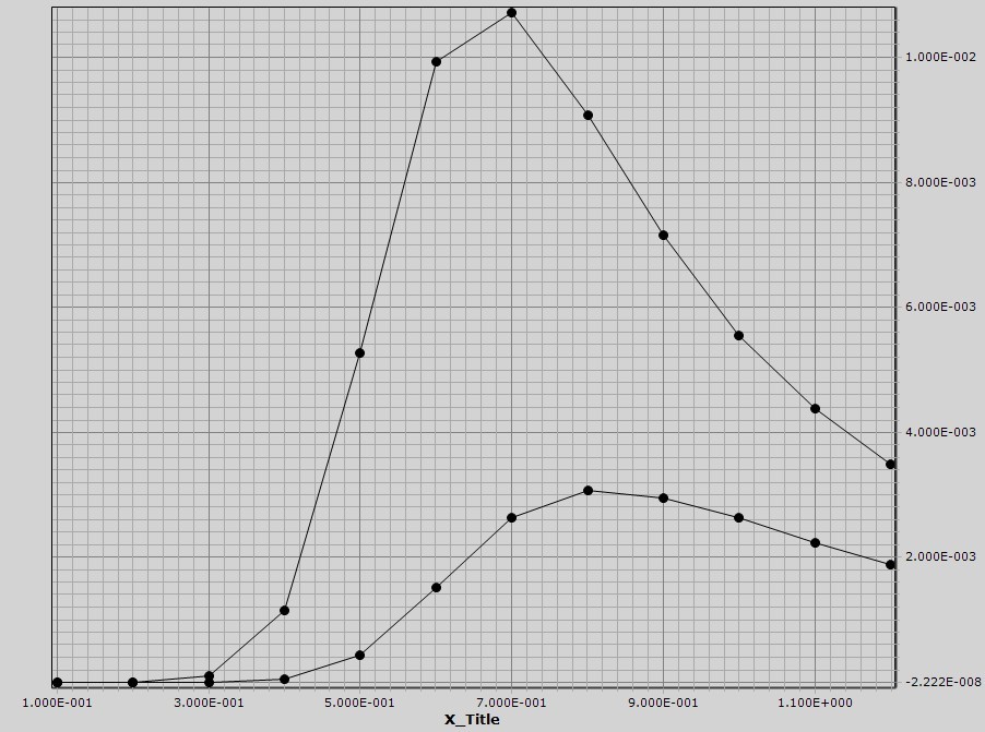

Ok. I suggest other solution, where I have drawn the title of vertical axes directly in the canvas.

Ok, thank you very much, I achieve as you said.
