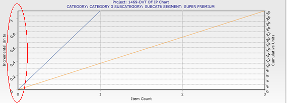

Hi Steema Support Team,
I'm using Steema Silverlight version. I need to put Y Axis Values(Left Axis) in consaistent dp format.
i.e. if Values on Left Axis are 0, 0.5, 1, 1.5 and 2 Then they should be displayed on Y Axis like 0.0, 0.5, 1.0, 1.5, 2.0
similarly
if Values on Left Axis are 0, 0.05, 0.1, 0.15,0.2,0.25,0.3 Then they should be displayed on Y Axis like 0, 0.05, 0.10, 0.15,0.20,0.25,0.30
So number of decimal palces in LabelFormat should be dynamic. So basically I want to calculate valueformat at run time on the basis of Left Axis values.
TeeChart.Axes.Left.Labels.ValueFormat="0.0"
TeeChart.Axes.Left.Labels.ValueFormat="0.00"
TeeChart.Axes.Left.Labels.ValueFormat="0.000"
I tried it by using TeeChart.Axes.Left.CalcIncrement property but its not returning the correct increment value unless the chart is drawn.

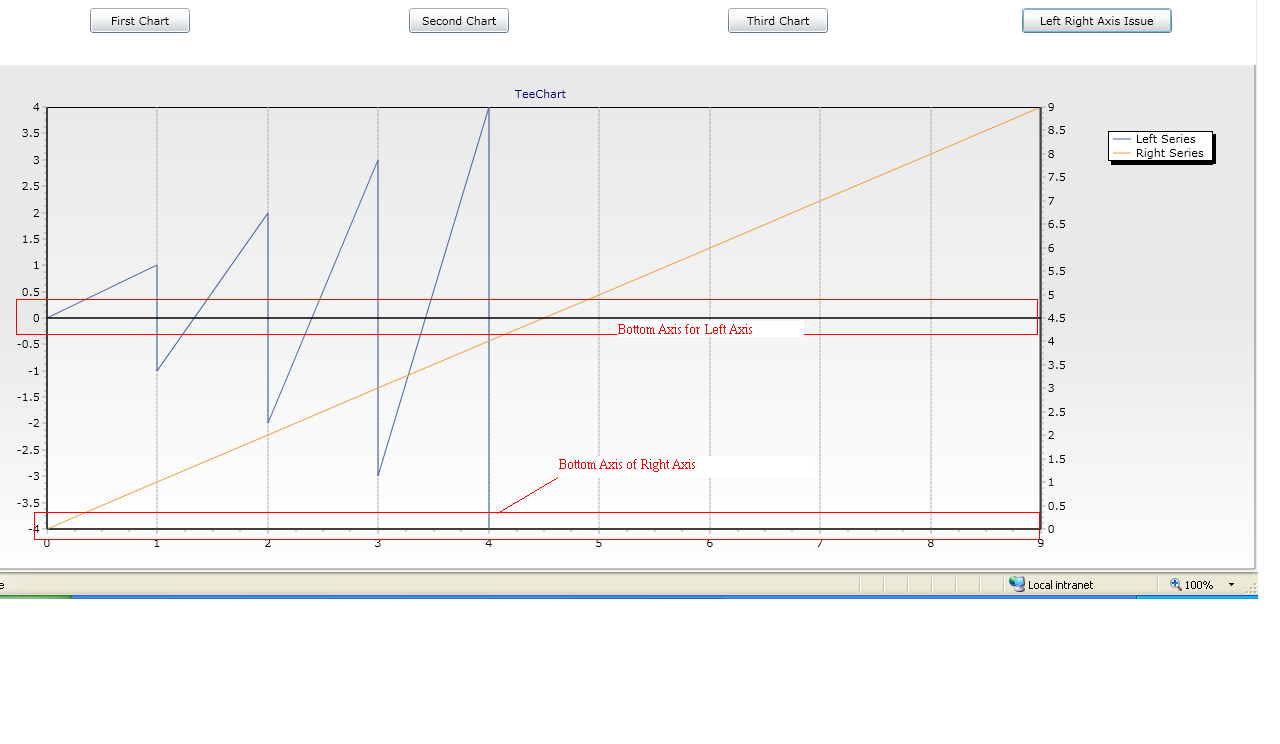

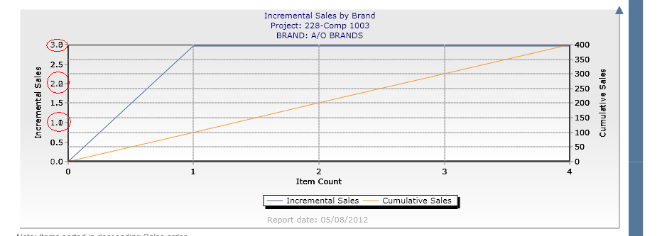

Problem#1: If you click on the first, second & third button you will see the overlapping issue of Axis labels.
As I don’t know what will be the incremental gap at the time of adding points to the Chart, I used the .Axes.Left.CalcIncrement property in the AfterDraw Event. I set the format of Y Axis and called the Axis.Draw method
Problem#2: If you click the Left Right Axis issue you will notice that we have different Bottom Axis for Left & Right Axis. Is it possible that I can have common Bottom Axis for Left & Right Axis. Refer the attached image(LeftRightAxisIssue.png). Also refer the output I want(its possible in Windows.NET Silverlight version) DesiredLeftRightAxis.PNG
