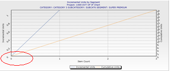

I'm using Steema Silverlight. My Left Y Axis Starts from Zero and Bottom Axis also starts from Zero. So I need a common Zero instead of 2 Zeros. In Windows .NET version it was working. Is there any way to achieve the same in Silverlight version.

I have try to achieve a common 0 using the same code with Winforms and Silverlight and I have gotten the same results in both projects and these are negative. Can you tell us, which values are you using to achieve a common 0 in Winforms? On the other hand, you can solve your problem using GetAxisLabel Event and remove the 0 you don't want as do in next code:
