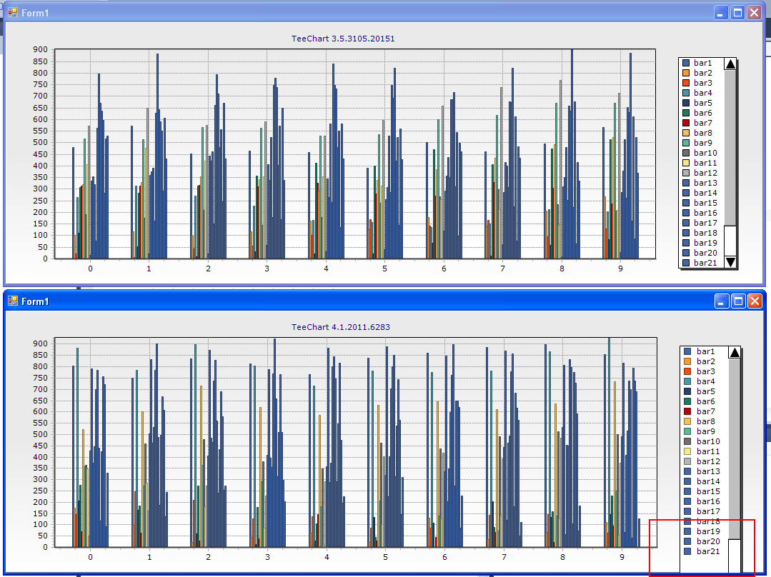

till last week we used TeeChart 3.5 (3.5.3105.20151) for over 4 years now but finally we upgraded to version 4.1 (4.1.2011.6283). In one of my first tests i found an issue with the LegendScrollBar tool. The size of the legend does not fit anymore and i have not found a usefull way to fix the problem for my own. In the attachment you can find an illustration of what i mean.
I used the following code for each TeeChart version:
readonly TChart chart;
    this.Width = 1024;
    this.Height = 368;
    chart = new TChart { Dock = DockStyle.Fill };
    chart.Aspect.View3D = false;
    chart.Header.Text += " " + typeof(TChart).Assembly.GetName().Version;
    this.Controls.Add(chart);
    var legendScrollBar = new LegendScrollBar();
    chart.Tools.Add(legendScrollBar);
    for (int i = 0; i < 25; i++)
        var series = new Bar(chart.Chart) { Marks = { Visible = false } };
        series.FillSampleValues(10);
The issue occure if you resize the form. The initially size of the legend is correct but after resizing it is wrong.
Did you have a fix or a workaround for this behaviour?
legendscrollbar issue.PNG (83.14 KiB) Viewed 9634 times

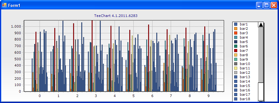

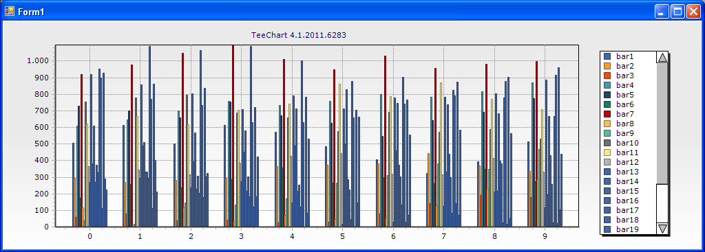

Hello Sandra,
sorry for my late delay, now i can give you an answer to your question.
No, your code does not work. Setting a fixed width but don't know how much space the labels realy require is not a good solution. In my real world progam i have 1 to 100 possible legend entries each with different text lenghts. I do not know how much space is required and is available (scrollbar). Why does the "AutoSize" does not work anymore? Before it satisfy all needs.
I attached the results of your code as screenshots.
Thanks for your help.
Initial after start
After resizing (made it smaller)
