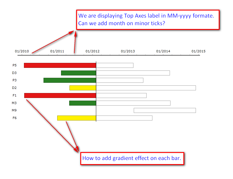

Hi Steema Support,
We are working in a Silverlight project in which we are using TeeChart 2010 .NET Silverlight Version.
In this project we have a chart which is Gantt Chart. We have following two queries:
1. We are displaying Top Axes label in MM-yyyy formate. We have a task to do, for adding month on minor ticks & years on Major Ticks. Please tell the possible solution for this problem?
2. How could we add gradient on each bar of Gantt chart?
For more explanation we are also attaching a picture which will clear our query.
Any suggestion will be highly appreciated.
Thanks and Regards
Plannoresearch
Thanks and Regards
Plannoresearch
- Gantt Chart queries.png (29.54 KiB) Viewed 18154 times

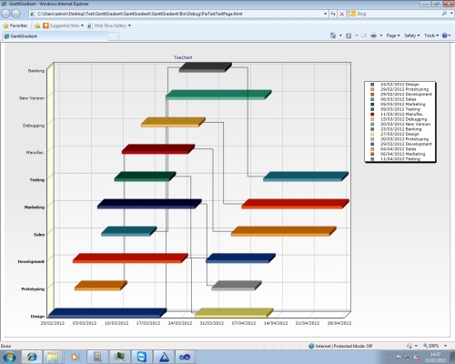

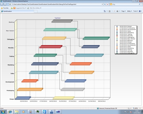

Re: Queries regarding Gantt Chart
Hello Planoresearch,
I have tested your project and works fine for me using last version of TeeChartSilverlight. Please can you tell us which version of TeeChart for Silverlight you are using?
In last version I have gotten next results:
Using Gradient: Without Gradient: Thanks,

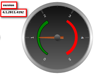

in our project we have one more chart having Gauge . Gauge was looking fine in the previous version i.e.( 4.1.2011.4192) but when i upgrade to the version 4.1.2012.1033 then gauge is not looking prominent. Is it a bug or any other issue?
Please suggest me. I am attaching the images for the same.
Planoresearch
Thanks for your information. I could reproduce your problem and I have added it in wish-list with number [TW24016063]. We will try to fix it for next maintenance releases.
