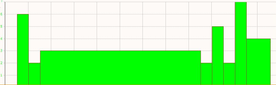

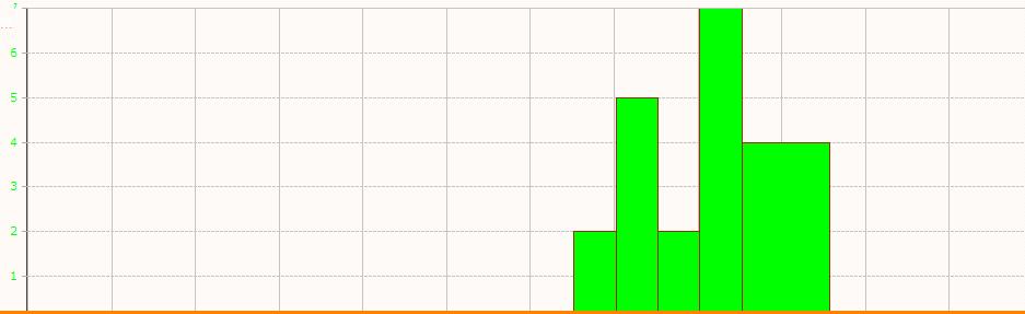

i have a problem with the last column width in bars series.
all the other bars are in the same size and the last bar gets a different size.
in addition, when i have two groups of data with some space between, the last bar of the first group resize and stretch to join the first bar of the second group.
see attached screenshots.
i tried to change offsetPercent and BarWidthPercent but i couldn't solve it. i don't want to set CustomBarWidth because i will lose the ability of the teechart to change the bar size as a function of the size.
i just want that the last bar will be in the same size of the others.
what can i do?

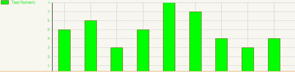

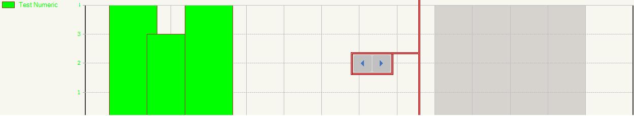

In addition, it seems like something in the axes change.
see axes differences in attached pictures.
