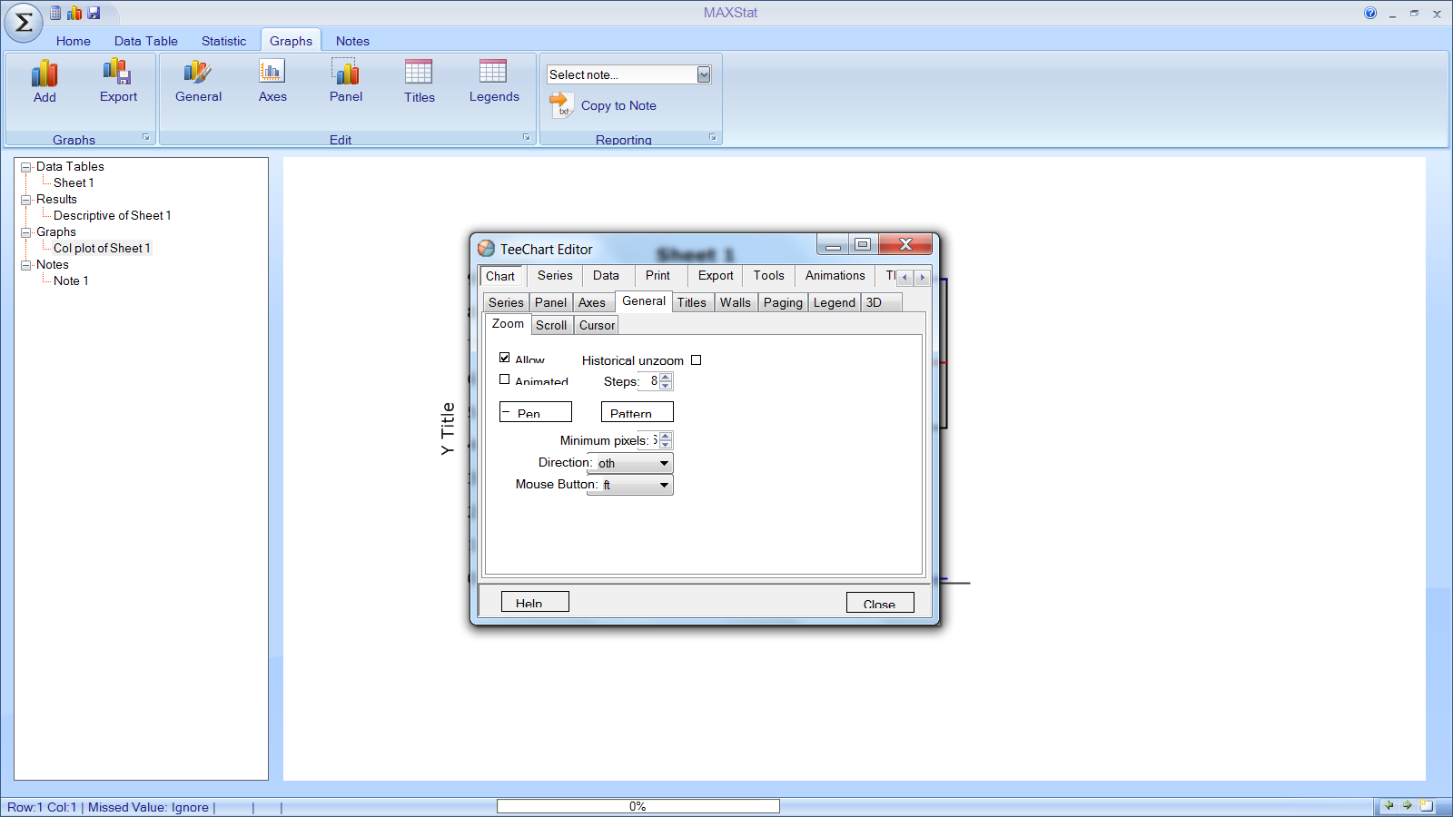

I tried changing the size of the dialog box of the editor. However the following code does not resize it, the dialog remains it is original rather small size. Any help would be great to fix it.
GraphEditor = New Steema.TeeChart.Editor(NewChart)
GraphEditor.DefaultTab = Steema.TeeChart.Editors.ChartEditorTabs.Axes
GraphEditor.Size = New System.Drawing.Size(800, 500)
GraphEditor.ShowModal(GraphDesktop)
Please see also the attachment showing the editor with controls overlying each other, and too small to show its content completely. How can this be fixed? Is that caused by computer configurations (screen resoution)?...I work with 1600x900, so should be plenty to show everything.
Oliver

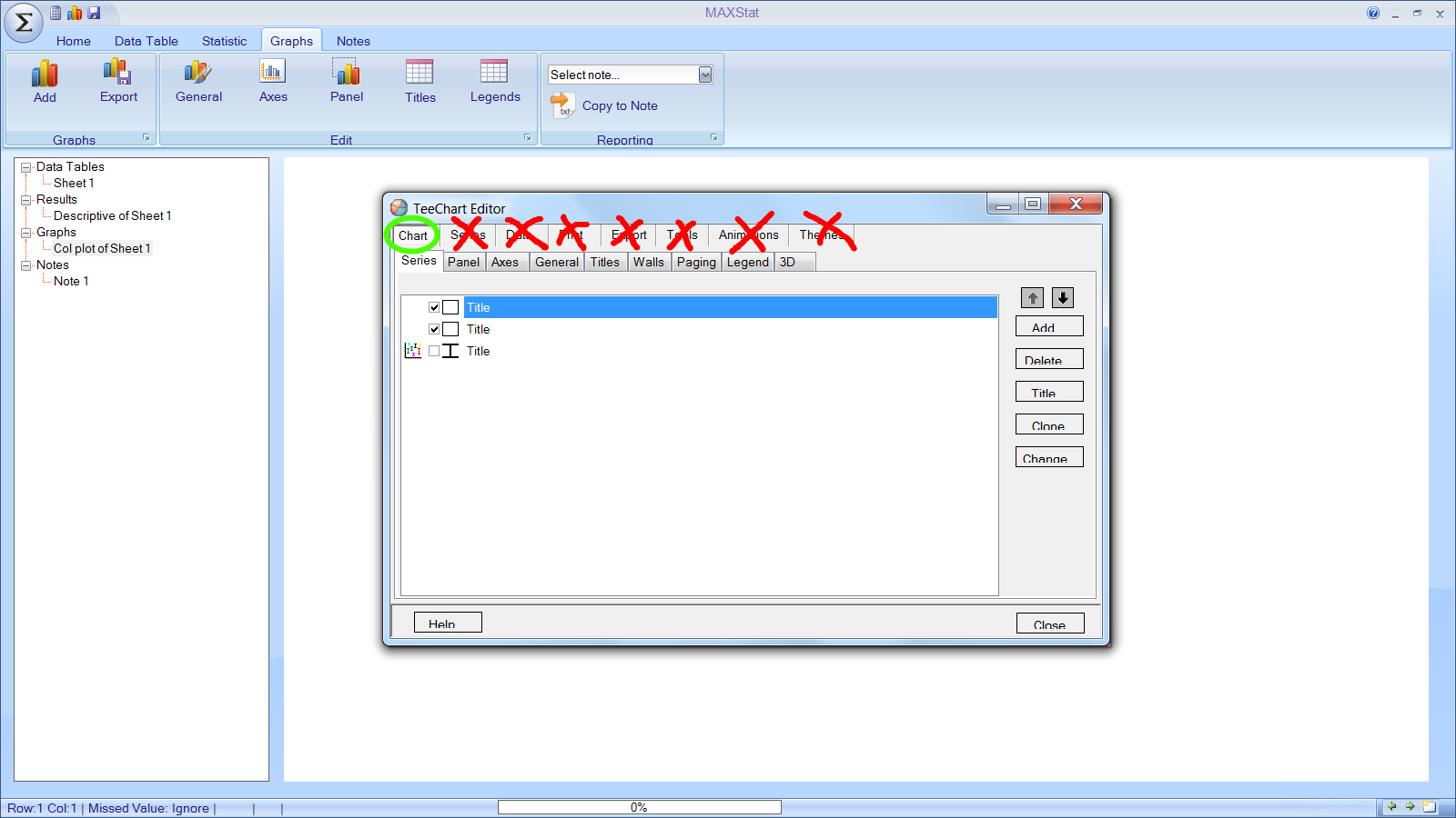

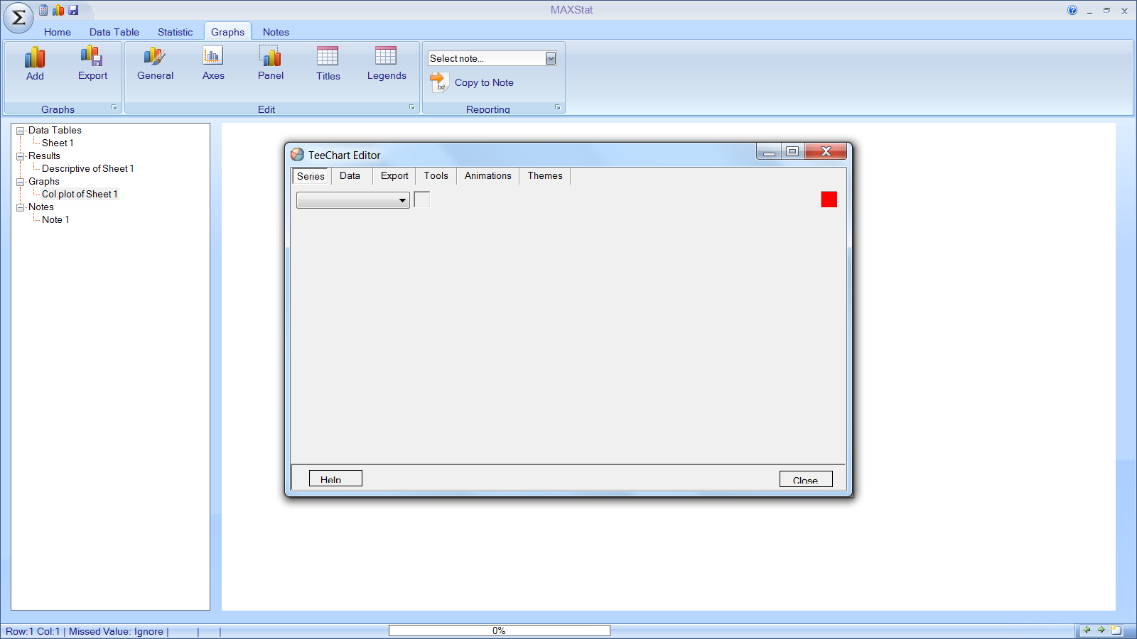

I figured out how to resize the editor, but its content is still kind of "messy". From previous posts I learned that it is not a new problem. Any comments on how and when this can be improved?
I am now trying to display just the tab "Chart" in the editor (see attachment Editor_1), but when I use the following code to remove the "Print" tab first, several other tabs get hidden (see attachment Editor_2. Why is that? And how can I hide all tabs except the "Chart" tab.
Thanks for help,
Oliver
Thanks for help,
Oliver

Hi Sandra,
thanks for your reply. The code you sent me is similar to what I used, and it seems I found the problem. If I hide all tabs, the chart tab is shown. However, it seems it is not possible to show the tab chart and print, for example. In such case only the tab print is shown, but not the tab chart. Is it a bug? I am using version V2011 (4.1.2012.1032).
I am also wondering if you know why some of the controls in the editor are not displayed properly, some are cut off. Please see my earlier posting with the attachment.
Oliver

I read about other posts reporting that controls in the editor run in each other. For example:
http://www.teechart.net/support/viewtop ... ols#p39259
I really need to figure out how the display the editor properly as every of my customer will complain about it. Is there a way to resize the controls of the editor, for example with screen size resolution. That is typically not necessary, but I am wondering if that could be the root of the problem.
Oliver

Hi Sandra,
Yes, set the default tab resolve the problem.
However, I am struggling with the proper display of the editor as controls are still overlapping each other, although I set a large size of the editor.
Oliver
