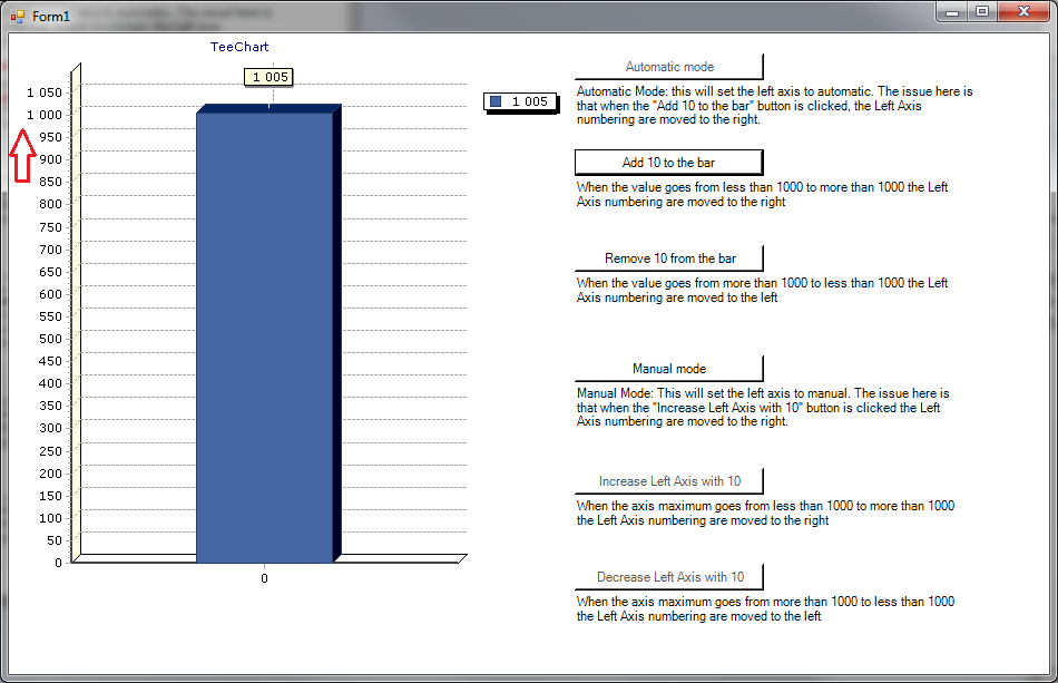

Attached is a small project which simulates the issue. Setting the Panels Transparent property to true, rather than the Visibility to false solved the issue where the control was drawn outside of its left most bounds. Setting Margin helped a bit together with the Units set to pixels rather than percent since we want a fixed margin rather than a dynamic margin. The problem we now have is that the margin is still not always fixed at the margin specified but seems to be relative to some virtual left axis maximum value as the sample illustrates.
What we need is for the control to always be rendered within its bound at a fixed top left margin, no matter what.
The problem occurs easily in the sample in these cases
* Axis is automatic and the bar value is increased from less than 1000 to more than 1000.
* Axis is manual and the Maximum Axis value is increased from less than 1000 to more than 1000.
Is there some way to get the chart drawn at an exact margin from the left corner?

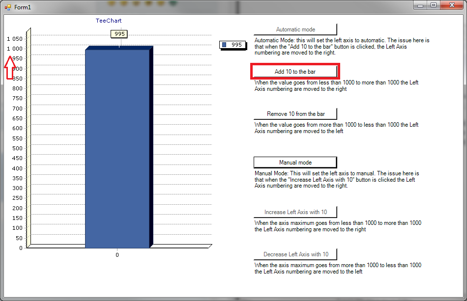

Hello Sandra,
Did you run the sample I sent with the last post? It has 6 buttons which clearly illustrates the issue. You need to push the "Add 10 to the bar" button or the "Increase Left Axis with 10" button.
Attached are two images which visualizes the issue. As you can see, the space from the Left corner is increased in the After image.
We want the spacing from the Left corner fixed.
Thanks in advance

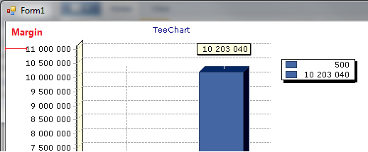

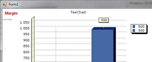

Hello Sandra,
The problem is slightly modified when using the custom Axis.
When using the following code the Axis is drawn at a fixed right position. We need the left position to be fixed.
Is it possible to modify the following code in order to get the left position of the axis to be locked? That is, the axis should be at a fixed margin from the left boundary at all times.
Small value.png (16.14 KiB) Viewed 13723 times
big value.png (22.83 KiB) Viewed 13732 times

BeijerElectronics
Posts: 30
Joined: Tue Sep 13, 2011 12:00 am
Re: Chart is drawn outside left bound
Post by BeijerElectronics » Wed Feb 29, 2012 9:55 am
Hello Sandra,
With the code provided, the axis is still not at a fixed left margin.
Current situation
Small value_1.png (9.14 KiB) Viewed 13730 times
big value_1.png (9.41 KiB) Viewed 13730 times
Expected situation
Expected_Small value_1.png (9.32 KiB) Viewed 13734 times
I hope this makes it more clear.
Thanks in advance
