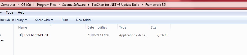

In TeeChartNET3UpdateBuild file,there is no Tchart.dll for .net3.5(3.jpg),but my project is .net3.5.Can we user tchart.dll for .net2.0?
Yes, you can use .net2.0 dll without problems, in your projects made in .net3.5

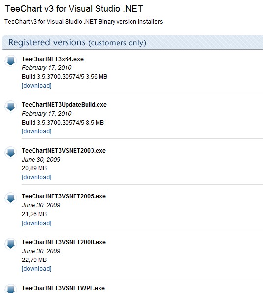

I have upload the list version in my customer page(1.jpg),please tell me which file is the last version,thanks?
In the customer page you can see TeeChartNET3UpdateBuild, this is the last version 3 update of Febrary, 2010, but before download and Install the update, you need download last version 3 of June, 2009 that in your case you need download TeeChartNet3Vnet2008 and install it. After you can install the TeeChartNet3UpdateBuild

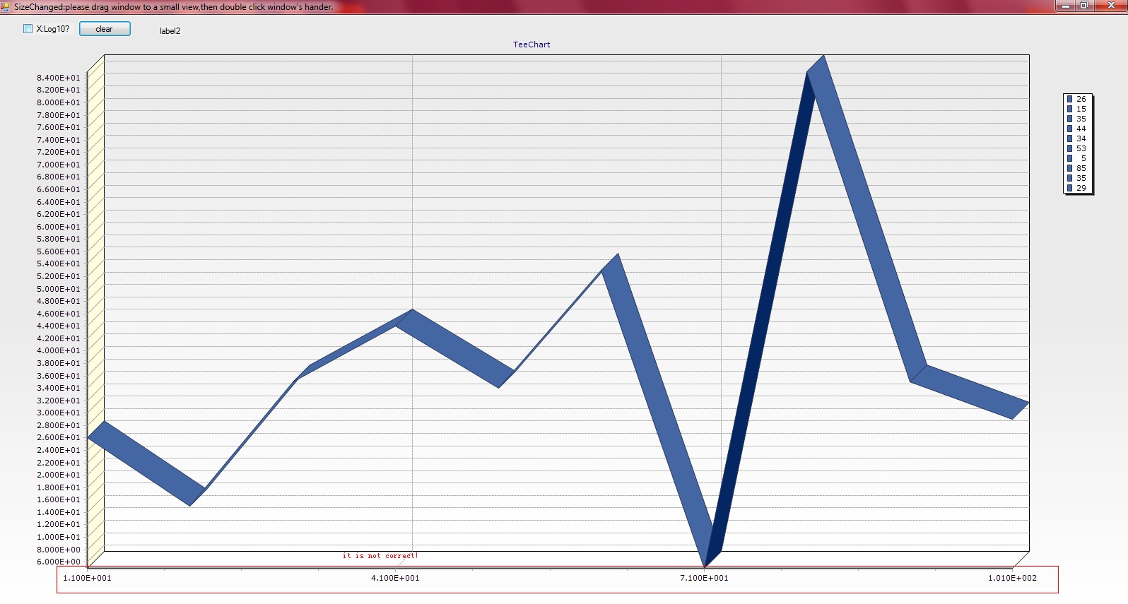

but this will refresh chartView twice,because I have Refresh after AfterDraw event!I did use AfterDraw event because the tChart1.SizeChanged() and tChart1.Resize() can not Calc correct XPosValue and Calc correct YPosValue.
I have uplaod my test project,please check this.
AfterDraw(),SizeChanged() and Resize() have been contained in this project.

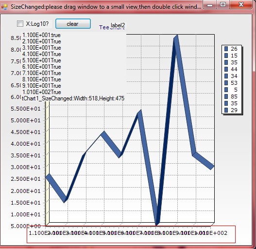

please run project ,drag window to a small window,then double click window's hander to maximize window(2.jpg),the Labels don't adjust correctly for SizeChanged() and Resize() .
And then double click window's hander to restore the small window status(3.jpg),the Labels don't adjust correctly for SizeChanged() and Resize().
I don't know what happened.
do you know why SizeChanged and Resize can not do this or there have any other event can do this and not refresh ChartView twice?thanks.
