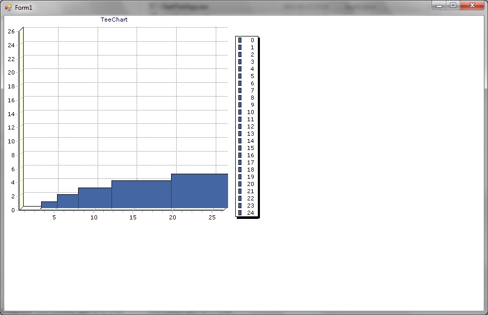

Re: Histogram chart crashes when both X and Y has values
Post by Sandra » Fri Feb 17, 2012 4:16 pm
Hello
Your project works fine for me using last version of TeeChart.Net and your code, please see next image:
Can you tell us which version of TeeChart.Net are you using?
