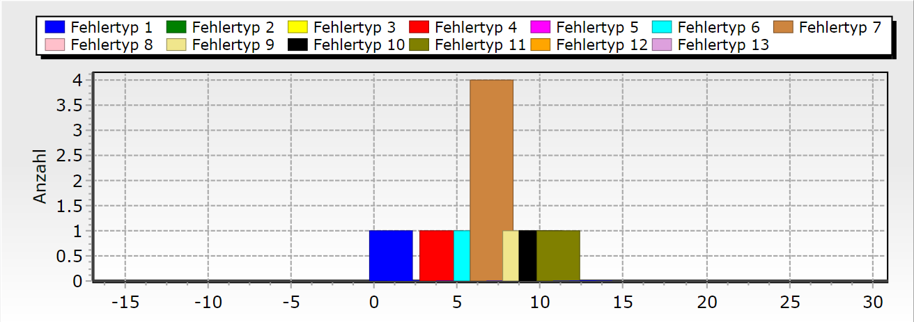

Hello support team,
I have a problem with teechart wpf version 3.5.3700.30575.

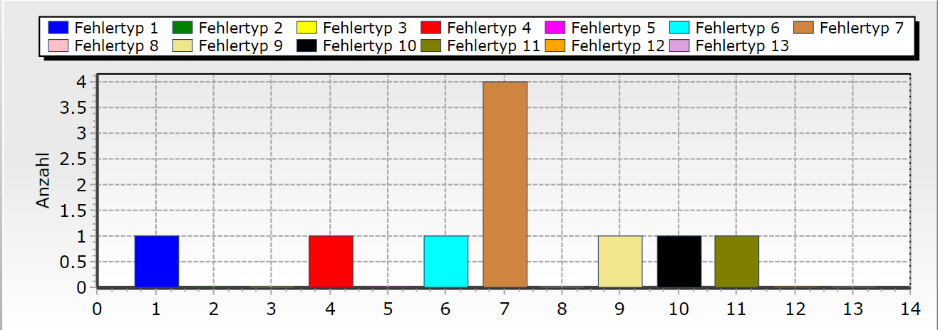

In my chart there are 13 series of type "Bar". I want the X-axis has a fixed value range from 0 to 14. The first load of the chart works perfectly, but when I refill the chart and set the axis minimum and maximum limits the wrong limits are displayed. The call of DoInvalidate() also takes no effect.
Here a code snippet, Automatic, AutomaticMinimum and AutomaticMaximum of X axis is set to False.
       private static void CheckMinMax(Chart aChart, bool isAuto)
            try
                aChart.tchart.Axes.Bottom.Automatic = isAuto;
                if (!isAuto)
                    //if (aChart.XMin != double.MinValue)
                    //    aChart.tchart.Axes.Bottom.Minimum = aChart.XMin;
                    //if (aChart.XMax != double.MaxValue)
                    //    aChart.tchart.Axes.Bottom.Maximum = aChart.XMax;
                    if (aChart.XMin != double.MinValue && aChart.XMax != double.MaxValue)
                        aChart.tchart.Axes.Bottom.SetMinMax(aChart.XMin, aChart.XMax);
                aChart.tchart.DoInvalidate();
            catch (Exception _e)
                Trace.WriteLine(_e.Message + " " + _e.StackTrace);
Please see also attached screenshots.

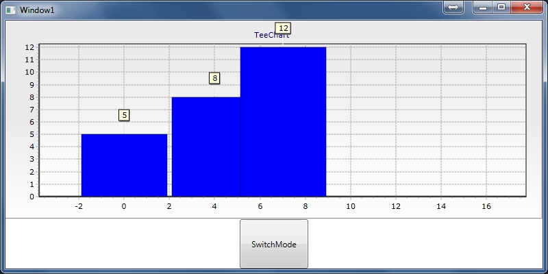

I have started your application. I have changed one row, it's the Automatic=False for unchecked mode (stacked). The effect is the same as in my test app. You set X min/max to -1 and 3, but I see -2 to 4. Why?

the problem is the following. Once I have set the Automatic = True to False and changed back again the limits for this mode the limits will not displayed. For example, I have 3 bar series with values of range 1 to 13 and I set minimum = 0 and maximum to 14, because I would like to have some space to the left and right, the chart displays a minimum value lesser than 0 and greater than 14 and the bars overlap.

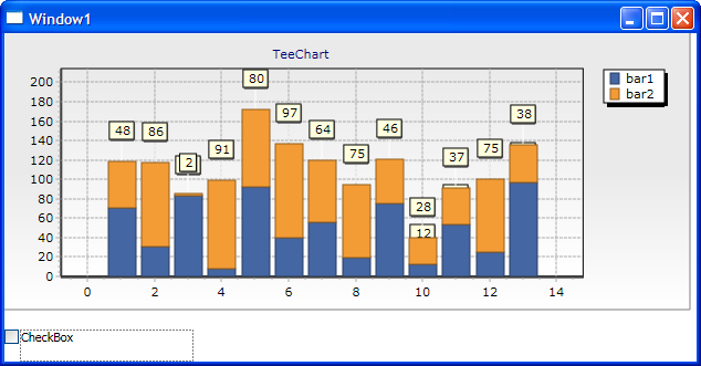

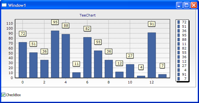

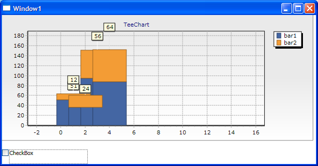

Post by Narcís » Thu Jan 05, 2012 12:33 pm
Hi Thomas,

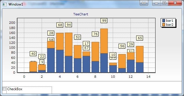

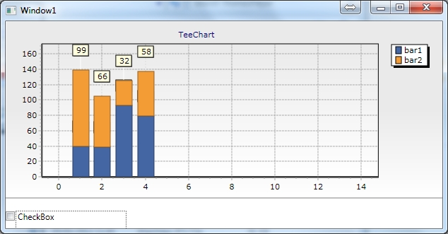

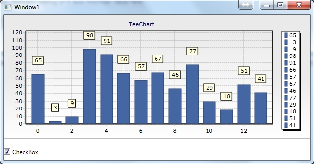

I don't see any problem with the projects you sent using latest TeeChart for .NET v3 release available at the client download area. The only difference in the code is that you add 5 values instead of 14 when the checkbox is unchecked but since bottom axis is set to 0-14 its scale is constant. Toggling the checkbox always produces the same chart here. Should I perform any specific step to reproduce the issue? Is that what you get?
Running both applications I get this:
When unchecking the checkbox I get this with the one with 14 bars:
And this with the one with 5 bars:
Enabling checkboxes again I get the same as the first image with both applications
Lothar Leischnig

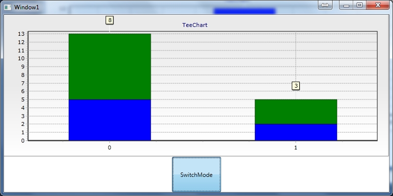

Posts: 12
Joined: Mon Jan 07, 2008 12:00 am
Re: Manually setting of X axis min/max value failed
Post by Lothar Leischnig » Thu Jan 05, 2012 12:50 pm
Hi Narcis, here are my screenshots.
