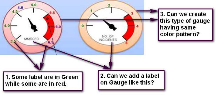

We are working on a project which is being created in silverlight and we are using TeeChart 2010 .NET SIlverlight version. We have some queries regarding Gauge Series as we need some customizations as mentioned in following lines:
1. Can we change the color of Value label of Gauge randomly. For example we want some of labels to be in green and rest in Red, as mentioned in following figure.
2. Can we add a label on the gauge as mentioned in following figure?
3. Can we change the color pattern of our TeeChart gauge as used in following figure?

Hello Planoresearch,
I recommend take a look in this link where explain how do you do to create your custom Gauge and I think is the best solution to achieve as you want.
In this case you can use Annotation tool to add the label in the middle of your Gauge. See some examples in All Features\Welcome !\Tools\Annotation.

Thanks for your valuable link,We have gone through your link and annotation example, but it is not helping us.
Please provide any alternate solution for the query 2.
2. Can we add a label on the gauge as mentioned in figure attached first post?
The other option for you is use Steema.TeeChart.Drawing.Graphics3D.TextOut method and draw the text directly in the canvas in the x and y coordinates, you can use method in AfterDraw Event as do in next simple code:
            g.TextOut(150, 120, "Circular Demo");
