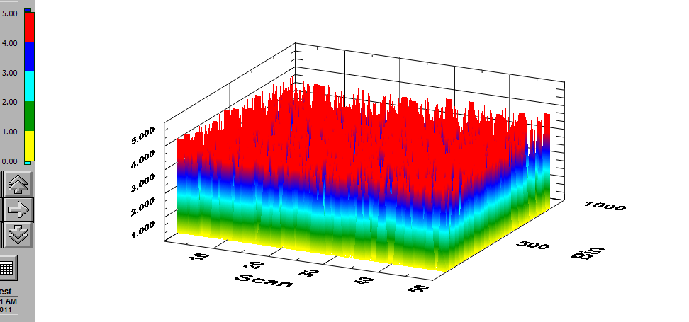

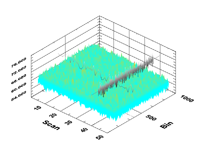

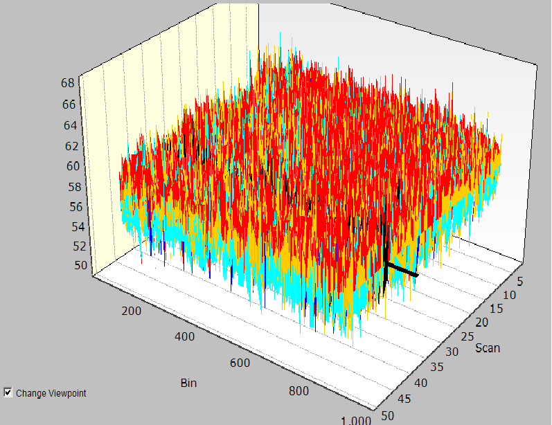

We are using TeeChart in our project to show data in 3D mode. The data shown is like spikes. We are using surface.Add(....) function of class Steema.TeeChart.Styles.Surface . Our requirement is to show data smoothly; ie instead of spikes it should show data in transitional way. I have attached following screen shots for you kind reference.
1.) TeeChartSpikes.png [This is how TeeChart implementation looks, it shows data in spikes.]
2.) CWGraph3D-SmoothGraph.png [We want data shown in teechart should appear like this screen shot. Here data representation is smooth and not in spikes. This graph uses control CWGraph3D]
I am using TeeChart version 3.5.3146.24805. Please let me know the option available to achieve data smoothness with mentioned TeeChart version.

- Smooth Data in control CWGraph3D
- CWGraph3D-SmoothGraph.png (99.38 KiB) Viewed 29279 times
- Spiked Data in TeeChart
- TeeChartSpikes.png (62.96 KiB) Viewed 29280 times

Thanks for your help but it may not be feasible in our case to hide many important things to make smoothing faster.
Coming to color tansition my requirement is I want to pass range values and colors as per following table:
0 yellow
1 green
2 cyan
3 blue
4 red
Now after adding data to surface series; if data value is 0 it should show yellow; if it is 1 then it should that value in color transition going from yellow to green.
Similary if data value is 4 it should show that value in such a way so that we can see all color from yellow to green, cyan, blue, red in transitional way.
[Please refer attached bitmap for refrence. Here control used is CWGraph3D. ]
Can you please let me know if same effect is possible in TeeChart also for surface series ?] I hope I'm able to explain my problem. Please let me know for any other inputs.
