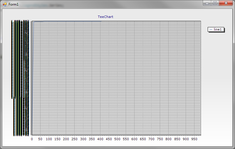

First of all, thanks for your reply. Actually I expect something else.
I noticed the data range on Y axis has been changed in your sample. But unfortunately for my case, the data range is from 0 ~ 1E+303. If I set back the data range, you sample code result will be like this:
[img]Screenshot.png[/img]
If I am not wrong, there are 303 labels rendered on Y axis but I hoped it can be less. To avoid overlapping, is there a way to hide some labels on Y axis?
Re: Overlapped Axis Labels in Log Scale
Post by Sandra » Wed Nov 09, 2011 12:09 pm
Hello eidola,
You are right. In this case, I think that would be useful for you, take a look in the Demo Project, concretely in All Features\Welcome !\Axes\Labels\Custom logarithmic axis where you can find how do to setup custom logarithmic increment.
