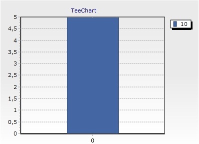

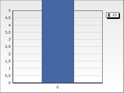

As you see, source TChart Bar (and other Series too) is out of visible area in exported XAML:
Source:
Exported:

Hello neurosoft,
You are right. I have added your request in bug list report with number [TW16015691]. We will try to fix it in next maintenance releases of TeeChart.Net.
