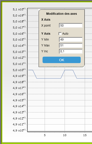

Just to let you know that I found an issue with the Label axes:
axes lebel issue
the axes is configure like this:
in_TChart.Axes.Left.Minimum = 49;
in_TChart.Axes.Left.Maximum = 50;
in_TChart.Axes.Left.Increment = 0,1;
in_TChart.Axes.Left.Labels.Exponent = true;
in_TChart.Axes.Left.Labels.ValueFormat = "#.0 x10 E+0";
If the ValueFormat is set to "#.00 x10 E+0", the label is well displayed.

I couldn't reproduce your problem using next code:
            line1 = new Steema.TeeChart.Styles.Line(tChart1.Chart);
            line1.Add(1.0);
            line1.Add(1.0e+1);
            line1.Add(1.0e+2);
            line1.Add(1.0e+2);
            line1.Add(1.0e+2);
            line1.Add(1.0e+2);
            line1.Add(1.0e+2);
            tChart1.Axes.Left.Minimum = 49;
            tChart1.Axes.Left.Maximum = 50;
            tChart1.Axes.Left.Increment = 0.1;
            tChart1.Axes.Left.Labels.Exponent = true;
            tChart1.Axes.Left.Labels.ValueFormat = "#.0 x10 E+0";
Can you please, tell us, if in previous code appears your problem? Moreover, if in code you can reproduce your problem, please explain how we can reproduce it here.

I am using the WPF version of TChart.
Re: Axes Label issue
Post by Sandra » Thu Aug 04, 2011 2:20 pm
Hello antonie,
Sorry, you are right and it occurs in WinForms too. I have added your request in the bug list report with number [TF02015683]. We will try to fix it for next versions of Teechart.Net

I have been able to reproduce it.
I enclosed the small I made to test it.

I've looked at this and I think it's more a .NET Framework issue than a TeeChart related one. Note that TeeChart uses the Framework functions to format the values to get the strings. The problem is actually reproducible without any chart, simply with the following code:
            double tmp = 4.95e+1;
            this.Text = tmp.ToString("#.0 x10 E+0") + "     " + tmp.ToString("#.00 x10 E+0");
