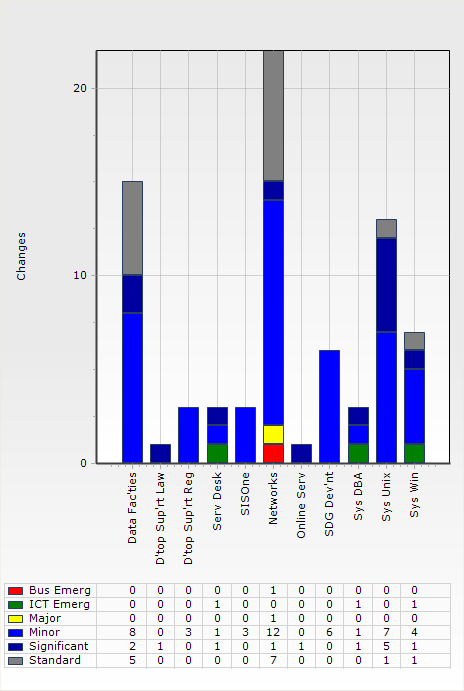

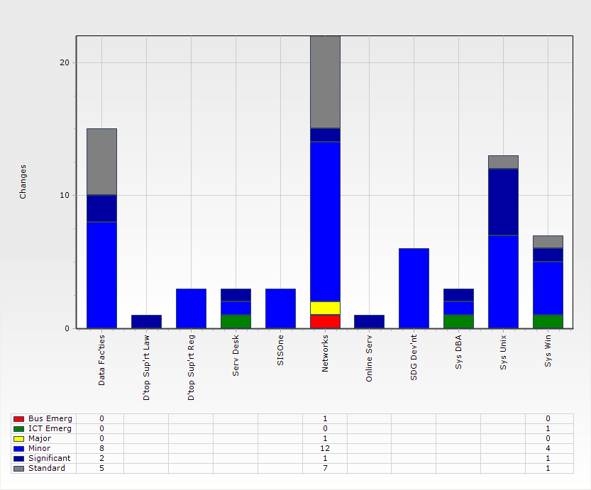

I've created a chart which includes a data table but the data in the datatable only correctly displays when the chart is small or very large.
This image is of the chart not showing all the data in the datatable.
If I resize the chart by dragging the window eventually the missing data appears, also, If I make the chart very large (i.e. drag the window across two screens) the data appears.

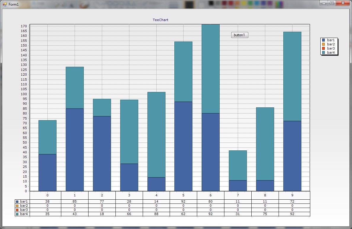

I have got next image where seems where your problem doesn't appears:
Can you confirm us, that in previous image doesn't appear your problem? If you consider that appears, please explain exactly where you think there is the problem.

I used your sample application found http://www.teechart.net/support/downloa ... hp?id=1928 and changed the number of bars from 5 to 10.
and the problem shows.

now using the mouse take hold of the right side of the window and very slowly make the window narrower, you will get to a point where the chart is about 15cm across where columns 1,3 and 5 dissapear, if you keep making it smaller they reappear then dissapear and so on.
My application has a need to include datatables in the chart output and my users want to export the charts quite small, about 15cm wide so it's fairly important that this gets resolved... after all I first reported this about 12 months ago and the last note I got on it was that it would be fixed in the next release.
