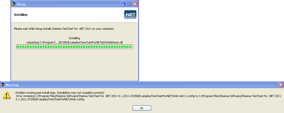

okHi Sandra,
Thanks for the quick response, I think what happened is that I installed it succesfully first time, then I had to uninstall because I'd left older versions installed and wanted to clean everything up. I then tried the install of the new version again and this is when the error occured.
The error appears after the license information screen.
I think I've figured it out. The uninstall did not remove the folder (C:\Program Files\Steema Software\Steema TeeChart for .NET 2011 4.1.2011.07280), with the folder in place the installation fails. I removed the folder and retried the install and it got past the point of the previous failure. It is now throwing the following warning, but looks like it has installed the main components.
tchart03-08-2011 07-10-52.PNG (28.13 KiB) Viewed 16834 times

Re: Unable to install July 2011 release
Post by Sandra » Wed Aug 03, 2011 8:17 am
Hello Captell
It is a known problem for us and It is already in wish-list with number (TF02015643) and thanks for your information we consider this information to solve the problem.
