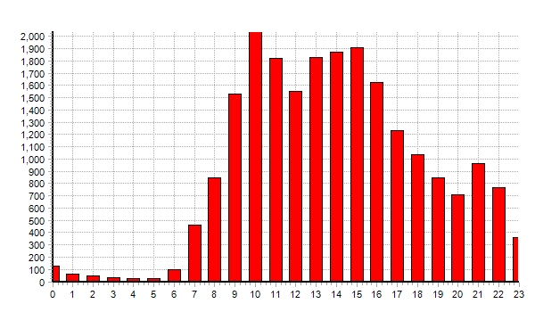

When I add the following:-
tChart1.Axes.Bottom.Automatic = false;
tChart1.Axes.Bottom.Maximum = 23;
tChart1.Axes.Bottom.Minimum = 0;
The bar for 0 and for 23 is cut in half, if I leave the axes as automatic the bars are then correct but I don't get a all values from 0 to 23 on the scale.
Any ideas?

Hello MiketheLab,
I couldn't reproduce your problem using next code with last version of TeeChart.Net:
            Steema.TeeChart.Styles.Bar bar = new Bar(tChart1.Chart);
            bar.Marks.Visible = false;
            bar.FillSampleValues(23);
            tChart1.Axes.Bottom.Increment = 1;
            tChart1.Axes.Bottom.Labels.Items.Clear();
            for (int i = 0; i < bar.Count; i++)
                tChart1.Axes.Bottom.Labels.Items.Add(bar.XValues[i], bar.XValues[i].ToString());
Can you check if previous code works as you expected? On the other hand, you can tell us which version of TeeChart are you using, now?

If I try your code it does not work on current version which is pretty old V1
I have downloaded the 2011 version and it then works.
Do you offer an upgrade option or is it a whole new licence?
