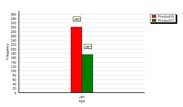

That was it, I added that file to the project and can now create graphs, however I only getting one bar per series, code is:-
Steema.TeeChart.TChart tChart1 = new Steema.TeeChart.TChart();
Steema.TeeChart.Styles.Bar bar1 = new Steema.TeeChart.Styles.Bar(tChart1.Chart);
Steema.TeeChart.Styles.Bar bar2 = new Steema.TeeChart.Styles.Bar(tChart1.Chart);
tChart1.Legend.Visible = true;
tChart1.Header.Text = "";
tChart1.Chart.Panel.Color = System.Drawing.Color.White;
tChart1.Chart.Panel.Visible = false;
tChart1.Chart.Walls.Visible = false;
tChart1.Chart.Panel.Bevel.Outer = Steema.TeeChart.Drawing.BevelStyles.None;
tChart1.Chart.Panel.Bevel.Inner = Steema.TeeChart.Drawing.BevelStyles.None;
tChart1.Axes.Bottom.Automatic = false;
tChart1.Axes.Bottom.Title.Visible = true;
tChart1.Axes.Bottom.Title.Text = "Age";
tChart1.Axes.Left.Title.Visible = true;
tChart1.Axes.Left.Title.Text = "Frequency";
bar1.Add(300, "Jan");
bar1.Add(325, "Feb");
bar1.Add(287, "Mar");
bar1.Title = "Product10";
bar2.Add(175, "Jan");
bar2.Add(223, "Feb");
bar2.Add(241, "Mar");
bar2.Title = "Product12";

Re: Console Application
Hi MikeTheLad,
That's because you set bottom axis to be manual. You can either remove this line:
Or set its min. and max. values manually like this:
tChart1.Axes.Bottom.SetMinMax(0, 2);
