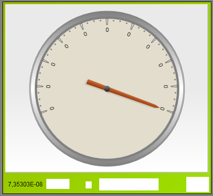

Post by antoine » Tue Aug 02, 2011 6:41 am
Hi Sandra,
I am have some difficulties to deal with the Axis of my gauge.
Has you can see on the picture, the labels on the Axis are all "0". At the bottom left you have the current value of the gauge.
gauge
I am using the following code to display the axis:
CircularGauge gauge = new CircularGauge();
gauge.Minimum = 0;
gauge.Maximum = 1e-9;
Steema.TeeChart.WPF.Axis leftAxis = in_TChart.Axes.Left;
leftAxis.Automatic = true;
leftAxis.AutomaticMaximum = true;
leftAxis.Increment = gauge.Maximum / 10;
leftAxis.Labels.ValueFormat = "#.#E+0";
in_TChart.Series.Clear();
in_TChart.Series.Add(gauge);
Thank you for your help,
Antoine.
Re: Gauge Logarithmic Axis WPF
Post by Sandra » Tue Aug 02, 2011 9:25 am
Hello antoine,
I think that your problem is, that you doesn't change the correct ValueFormat, so you are changing ValueFormat of labels of Axis and you need change ValueFormat of Value of gauge, as do in next example:
        Steema.TeeChart.WPF.TChart tChart1;
            tChart1 = new Steema.TeeChart.WPF.TChart();
            this.Content = tChart1;
            CircularGauge gauge = new CircularGauge(tChart1.Chart);
            gauge.Minimum = 0;
            gauge.Axis.Automatic = false;
            gauge.Axis.Increment = gauge.Maximum / 10;
            gauge.ValueFormat = "#.0x10E+0";
Could you confirm us if previous code works as you expected?
antoine
Posts: 15
Joined: Fri Jun 17, 2011 12:00 am
Post by antoine » Tue Aug 02, 2011 9:50 am
Thanks, it works!
