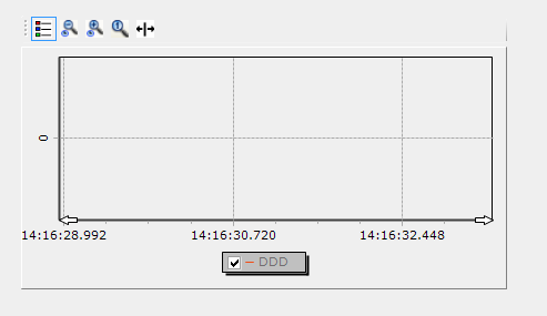

if i zoom in in the trend with milliseconds (set be Format property) is get some not "good" axis labels. Sometimes if I zoom in again, it will be repaired,
but I cannot accept the behavior, where I get such times as seen on the picture, how can I repair it?
If it would start with 14:16:29.000 because what our customer see is nothing, he can reference on.
Thank you in advance, Ivo Kovacka

Hello ifko,
I recommend that take a look in the demo project of TeeChart.Net, concretely in All Features\Welcome !\Axes\Labels\Showing milliseconds where there are a example of how you can works with labels in milliseconds and I think can help you to solve your problem. If you have any problems please let me know.
