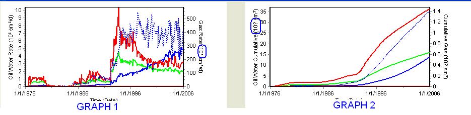

Please see the attachment "Example.JPG" for an output of the following code that I see on my PC.
Any help will be really appreciated

btitle.SetCaption("Oil Water Cumulative (10\u2076 sm\u00b3)"); // exponent 6 shows a "?" with unicode charater \u2076 in caption as seen circled in Graph 2 in attachment Example.JPG
- Example
- Example.JPG (43.05 KiB) Viewed 9129 times
