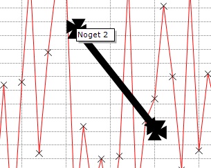

I found another workaround – in the NewLine event I set the sender.EnableDraw = false, and then create a new instance for each line I need.
Anyway – now I got another problem I can’t seem to figure out.
I would like the lines to be rather wide (10pix), resulting in that the ‘selecting points’ (I guess these are called Start- and EndHandles?) gets rather large (please see picture below).
Is the any way that I can set the size of these, or hide them, or ... (see next picture), makeing it look nicer? I know this is a rather dump question, but I just can’t figure it out.

At the moment the annotation callout points at the annotation textbox. So the arrow points from a point on the graph to the textbox.
What I would like the callout to do, is to points from the textbox, to a point on the graph. Kind of like the picture from my post "29 Apr 2011 11:08", pic: DrawLine2.jpg.
