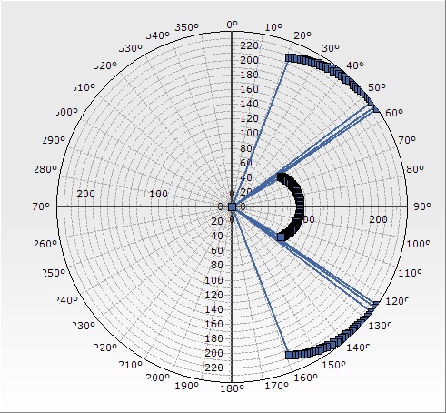

When I draw a Polar series wome of the angle labels, located on the outside circle, are getting clipped. It is happening to labels that are greater than 90 degrees. See attached JPEG file.

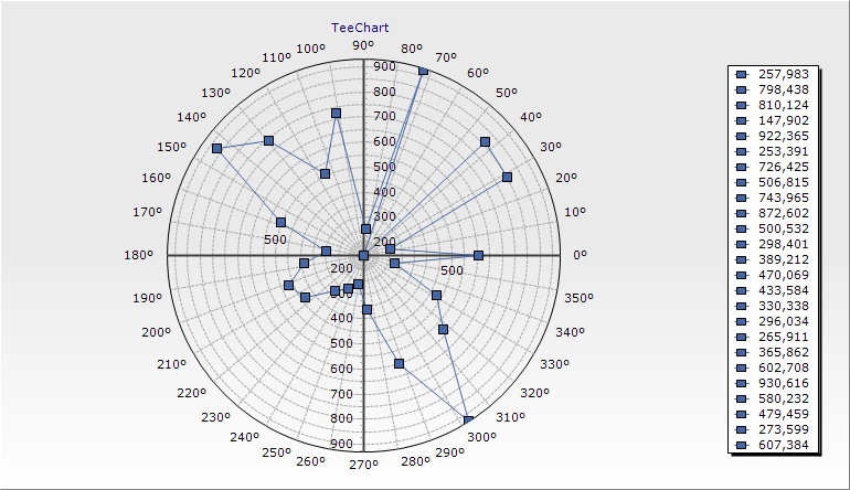

Using next simple code and using last version of TeeChart.Net:
        Steema.TeeChart.Styles.Polar series1;
            series1 = new Steema.TeeChart.Styles.Polar(tChart1.Chart);
            series1.FillSampleValues();
            series1.Circled = true;
            series1.Brush.Visible = false;
            series1.CircleLabels = true;
And I have gotten next image:
Could you check if your problem appears using previous code? Moreover, can you tell us, which version of TeeChart.Net are you using, now?

I will check your code tomorrow. I wanted to add that I am using the following event handlers to clip data outside the display space.
private void polarChart_BeforeDraw(object sender, Steema.TeeChart.Drawing.Graphics3D g)
g.ClipEllipse(polarChart.Chart.ChartRect);
private void polarChart_AfterDraw(object sender, Steema.TeeChart.Drawing.Graphics3D g)
g.ClearClipRegions();
I am wondering if this causes the labels to be clipped.
Re: Polar Series Axis Labels
Post by Sandra » Mon Apr 11, 2011 10:41 am
Hello John,
I could reproduce your problem and this is caused to ClipEllipse. Could you explain exactly because you need ClipEllipse, so we can find a solution for it ? On the other hand, if you reduce the margin of labels, you can get that these appears correctly . You can do something as next:
