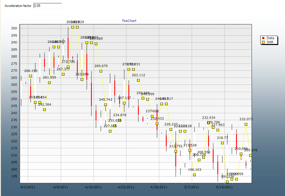

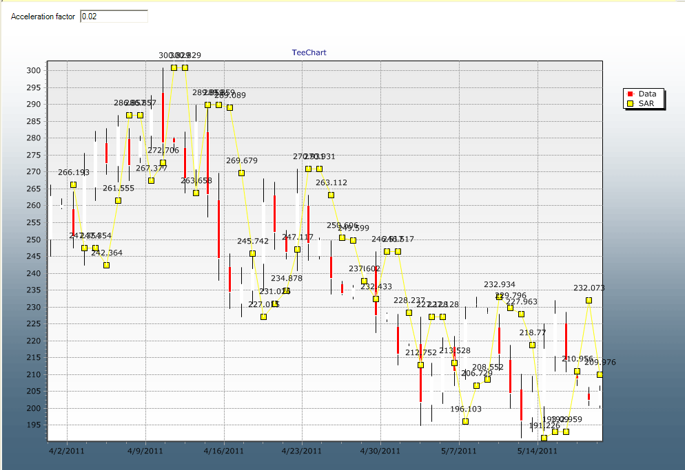

This is a screenshot of the SAR function in your demo. I have changed the number of points from 10 to 50. The top image has the default .02 Acceleration factor. The second image has an Acceleration Factor of .05. The chart does not change at all. Likewise, in my application when I draw a new SAR with .02 and then draw a second one with .05, the resulting lines match, with no differences.

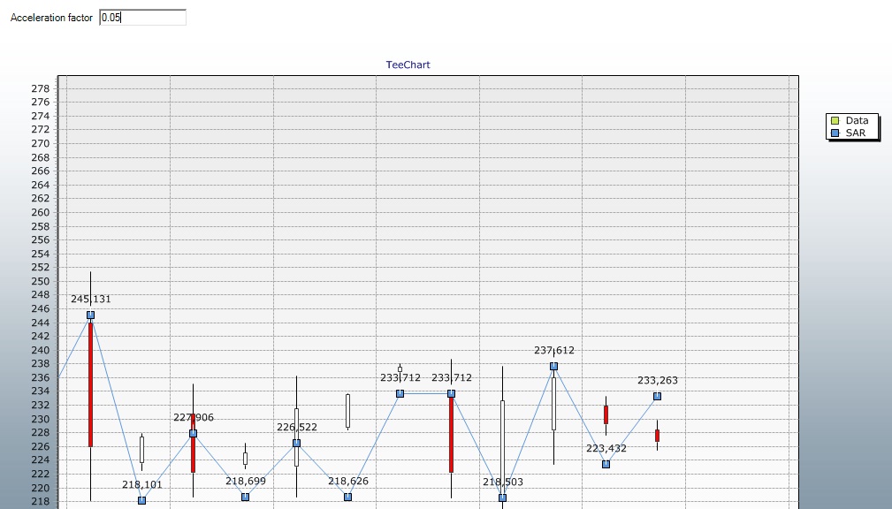

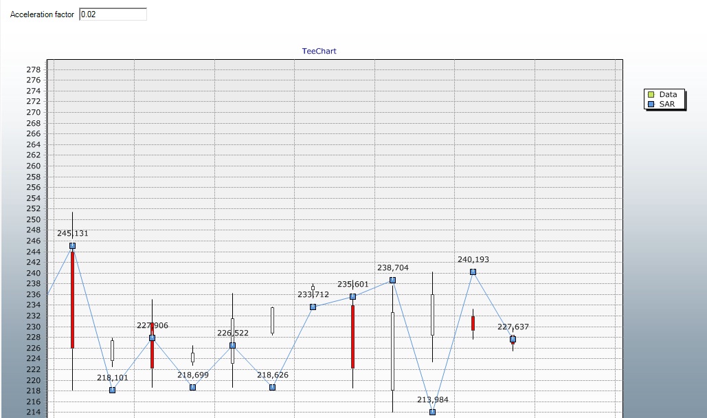

Using demo example and zooming a zone I have gotten next images, using last version of Teechart.Net :
The first image acceleration factor is 0.5 and in second is 0.2 and results are different for me. Could you please, check if in last version of Teechart.Net works as you expected?
