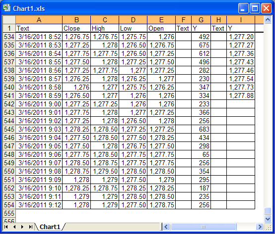

Assume you have a regular candle chart populated with data and overlayed on that you have a 14 period moving average. If you export the underlying data to a spreadsheet, the data for the moving average is aligned to the first row of the spreadsheet, not the last row. You can see what I am referring to in the following image. Notice that the right-most column ends at row 541. On the chart, that data is shown on the last bar, which is row 554 on this table.

The function series has less values than the source series due to its Period setting. TeeChart's Excel export picks series data sequentially and saves it into Excel columns until there's no more data for a given series. Excel rows have no significance here, what's important is that X values for all series are exported correctly.
Having said that, we don't think this should be considered a bug. Anyway, we will add your request to the wish-list to be considered for inclusion in future releases.
In the meantime, the only solution available is moving rows so that X values for all series match in the same row. You could do it manually or probably also using an Excel macro.
