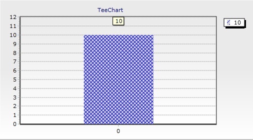

I want to add Bars with hatch styled brush to my WPF TChart. And I want to show Legend of Bar. I use following simple code:
            MyTChart.Aspect.View3D = false;
            Bar bar = new Bar();
            bar.Add(10);
            bar.Brush.Style = Steema.TeeChart.WPF.Drawing.HatchStyle.DiagonalCross;
            bar.Brush.Color = Colors.LightGray;
            bar.Brush.ForegroundColor = Colors.Blue;
            MyTChart.Series.Add(bar);
But image in the Legend (BackwardDiagonal) does not correspond to brush of Bar (DiagonalCross). You can see it on the attached picture:
The question is how can I set correct Legend HatchStyle?

I could reproduce your problem here and I have added your requests in bug list report with number [TW16015422]. We will try to fix it to next maintenance releases of TeeChart.Net.

We have downloaded latest release of TeeChart (TeeChart.NET version 2011Build 4.1.2011.04193). Bug [TW16015422] in Release.txt is marked as Fixed. But I reproduce this bug by using code posted above.

I can reproduce your problem and we are working with it. We have inform you asap.

Hello neurosoft,
For some reason the bug doesn't fixed, but now it is fixed. And it would be available to next maintenance release. On the other hand; can you tell us if you have source code of TeeChart.Net? So if you have source code and you need fix of this bug, yet we can give you the fix.
