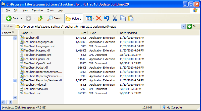

After running the installation I had some problems with it. I discovered that the installer did not overwrite existing files in the (default) target folder. In the screen shot below you can see the file dates left over from the 11/30/2010 installation. Some new files are there, but the important files are still the out of date files.

- If I install in a folder that held an earlier version of the application, including the 11/30/2010 version of TeeChart.Dll, EVERY file is updated just fine, EXCEPT TeeChart.Dll. The old 11/30/2010 file remains and the program can no longer open the form containing my TeeChart control. This means I can not distribute updates using the new version of the DLL at this time.
I suspect that my install issue is the same as the install issue with your Wise-based installer. Perhaps Windows is not seeing the updated dll file as a new version. I have duplicated this issue on two different 32-bit XP-based machines. I am using the .Net 2 version of TeeChart.dll.
