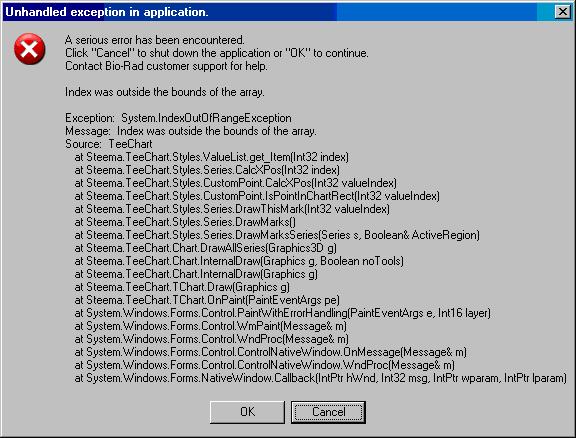

I have quite reproducible “Index was outside the bounds of the array” exception in TeeChart:
Here is the scenario:
1. There are several FastLine Series and Points series in the TeeChart control.
2. In run time, various threads are asynchronously adding points (5 points per second per series) to the series using invocation:
if (chart.InvokeRequired)
chart.Invoke(. . .);
3. X-axis is rescaled in runtime: as soon as any data point reaches the right margin of the graph, x-max is increased
Axes.Bottom.Maximum = Axes.Bottom.Maximum * 2;
so there is always a gap between the last data point in the series and the right margin of the graph.
4. Zoom in on the gap and there is an exception in the Points series.
Could you recommend a solution for the problem?
Thank you
Vladimir
- Newbie
- Posts: 4
- Joined: Mon Nov 15, 2010 12:00 am
- TeeChartException.JPG (60.42 KiB) Viewed 4134 times

I did not have a chance to create a simple project for you to reproduce the problem. I managed to find a solution though. I hope it could help others, as I saw some mentioning in the forums about similar exceptions related to the Points series.
To overcome the problem, I derived from the Points series and overridden some functions. In my particular case one of the functions along the exception path was the IsPointInChartRect(int32 valueindex). It turned that the index could sometimes be -1, which obviously created problems within the Points series. Now I use my PointsEx series instead and it seems working all right.
