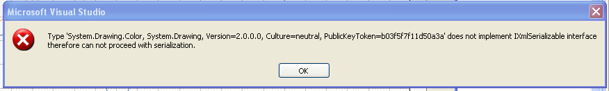

Whenever I add a Steema TeeChart for .Net v3 to a form in a VB.Net 2008 whenever I try and save I get the error in the attached image file.
Type 'System.Drawing.Color, System.Drawing, Version=2.0.0.0, Culture=neutral, PublicKeyToken=b03f5f7f11d50a3a' does not implement IXmlSerializalbe interface therefore can not proceed with serialization.

So I traced through and here's what I think happened -- one of the workstations that upated this project (Using Visual SVN) had updgraded to this version of TeeChart but didn't have the latest update.
After this update -- they checked in the solution and then other workstations got the latest code from source control and started receiving the errors above.
So we upgraded the problem workstation to the latest and greatest version of TeeChart and then manually removed all code being flagged by .Net as errors and checked in the project and updated all workstations to the latest source code and voila -- the problem is gone! :)
